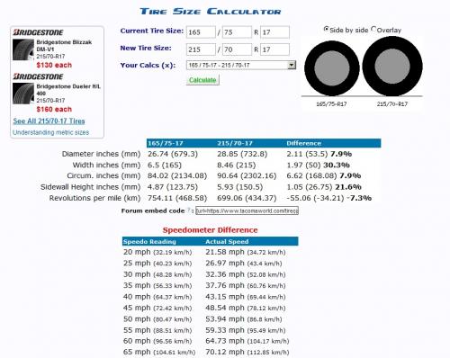

Formulabruce Posted September 30, 2015 Posted September 30, 2015 This may help, 2 pictures. 195 is very odd size., 185 and 215 are available.see pics/charts of what they do. should only be 2 images but I see 3, one is a duplicate. Probably clickable LINK to play with tire size calculator> https://www.tacomaworld.com/tirecalc?tires=165-75r17-185-70r17
kstruckcountry Posted September 30, 2015 Posted September 30, 2015 The confusion might be that your tires are actually 265/70/17
TimmyG Posted October 1, 2015 Author Posted October 1, 2015 The confusion might be that your tires are actually 265/70/17I knew that, now i wonder if i told the guy the wrong size tho... these numbers make my head hurt Sent from my SM-G920V using Tapatalk
