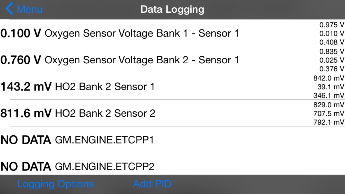

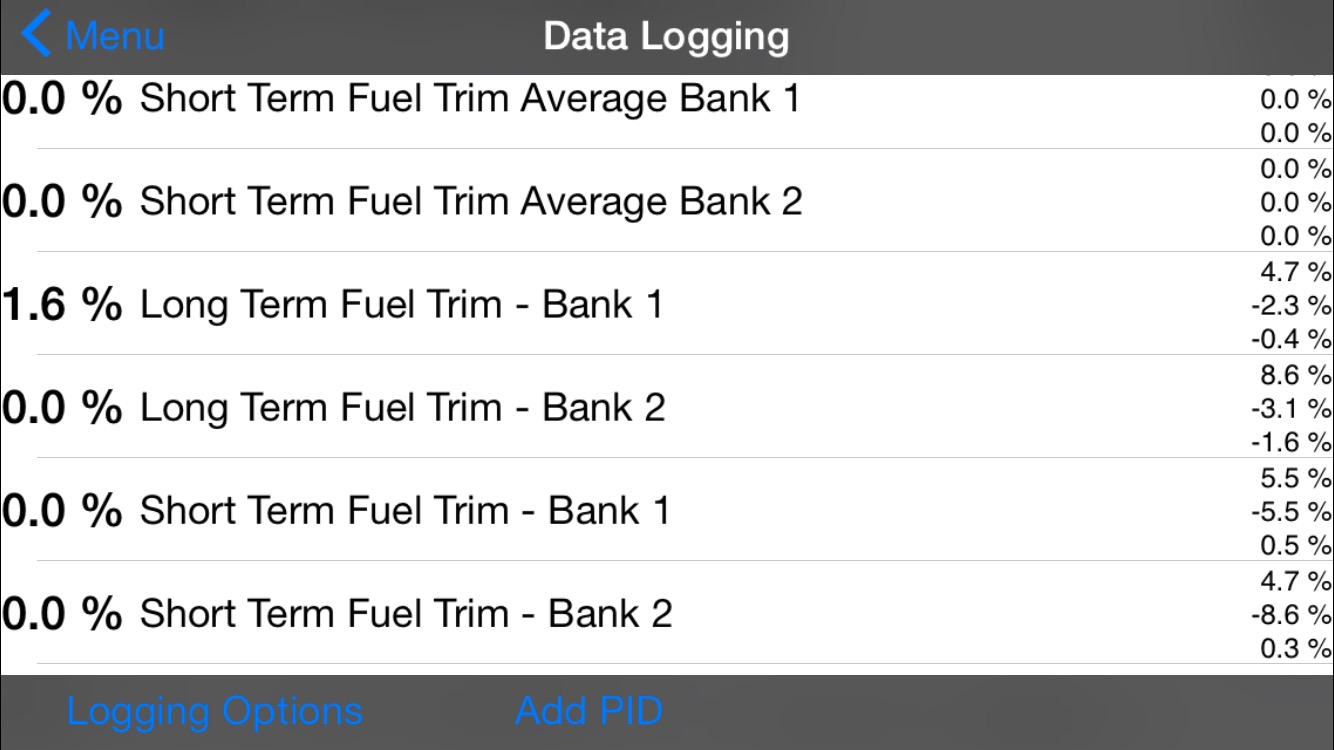

I bought a wireless scan tool. It is showing the bank 2 O2 sensor 1 is not working as it should. Stable read back where as Bank 1 sensor 1 is reacting to exhaust gas readings. LT fuel trims are as follows, Bank 1 is 1.6% and bank 2 is 0.0%. I am replacing the bank 2 O2 sensor tomorrow. I am also replacing the Bosch plugs I just installed over the summer with Denso Iridium plugs. I am thinking the ZTJ16 R10 plugs. Thoughts? Attached 2 screen shots of data below.

I just replaced both upstream O2 sensors. Truck seems to be running a little smoother. LT fuel trims are in the 7% ranges now and Bank 2's sensor is not sitting at high mV readback now. Will know more if the truck is fixed after some time. I am contemplating replacing the Bosh plugs with a set of ACDelco's I picked up yesterday. Hmmmmmm
