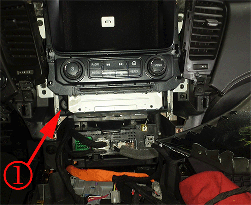

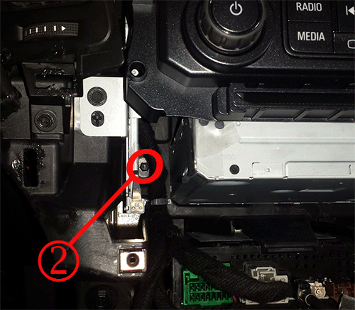

1 hour ago, Tahoeboss said:
No, I don't think so but not hundred percent sure any more.  They hold the "head" unit of the ac controls.  pull those and look behind that.  Its been two years and am having a hard time remembering.  Good luck.  drove me nuts till I found it.
Thanks man. I spent a few hours today trying. I ended up finding these photos online. I was struggling to find the screw til I realized in the photo the screen was up, and the wiring harness moved a bit.
Hope these photos help others.
