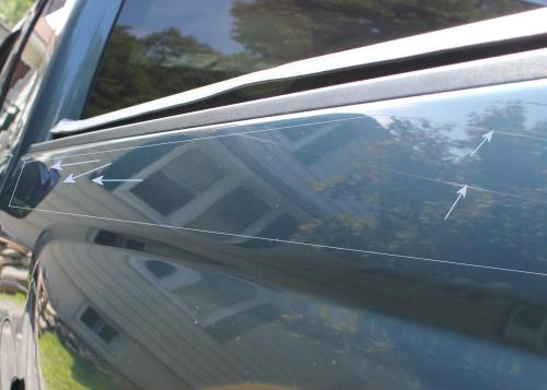

Later in 2014 I noticed the driver's side outer truck bed fender panel had some minor denting along the top ridge. I thought to myself, "darn, how'd that happen?". Did some knucklehead kids hit it with a frisbee or ball. It was not bad enough at that point to warrant any worry. I figured I would pay a dent guy $150 or so and get it fixed sometime.
A couple of weeks following the appearance of the dents, I had the 5th wheel hitch system installed in my bed. A few days later, we picked up our new 5th wheel trailer (trading in our class A). Aside from having to put in some Timbren's to raise the rear about an inch (which totally leveled out the truck) our Silverado 1500 towed like a dream!

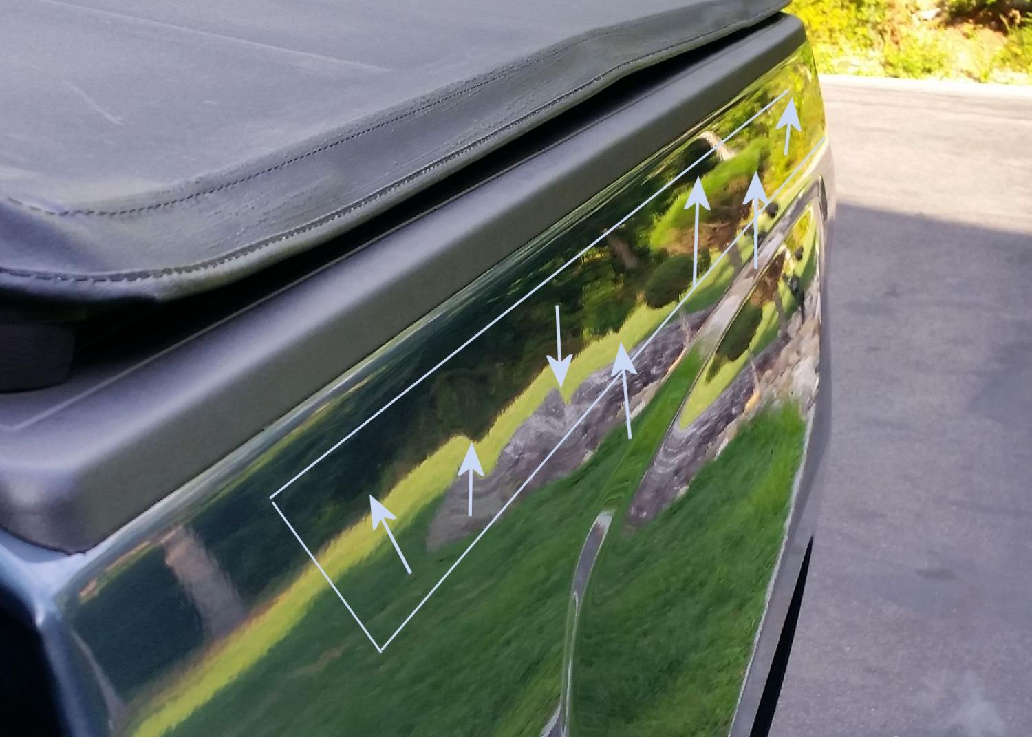

By August the dents were showing up on both outer bed panels and even some by the wheel wells. Which, by the way, were showing up without towing for two months! Now I knew something was up.
In September after quite a long battle with the dealership, they agreed to, under warranty, pull all the dents. One of the dealership's claims was that my 5th wheel towing was causing this issue. They could not be more wrong. It's actually due to a bad metallurgy in the panel and or some failure of the glue used to attached the panels that is temperature triggered.
When I picked up the truck after the dent guy did his magic, I was very happy and thought that would be the end of this weird self-denting thing. We towed with and drove the truck from September 2014 to May of 2015 without any issue and no re-occurrence of the dents.
In mid-November I took the hitch out of the truck. Then in May, before I put the hitch back in and towed anything, a couple of dents reappeared. By June, 2 or 3 dents turned into 5. Now, in early November 2015 I am back to 7 to 9 dents in the outer driver side rear truck bed panel.
