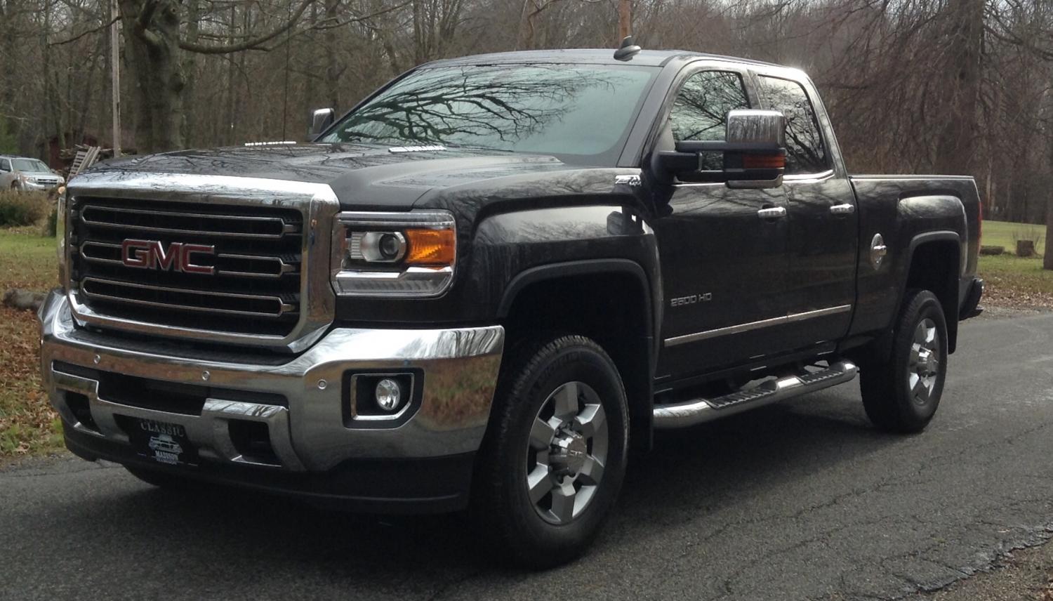

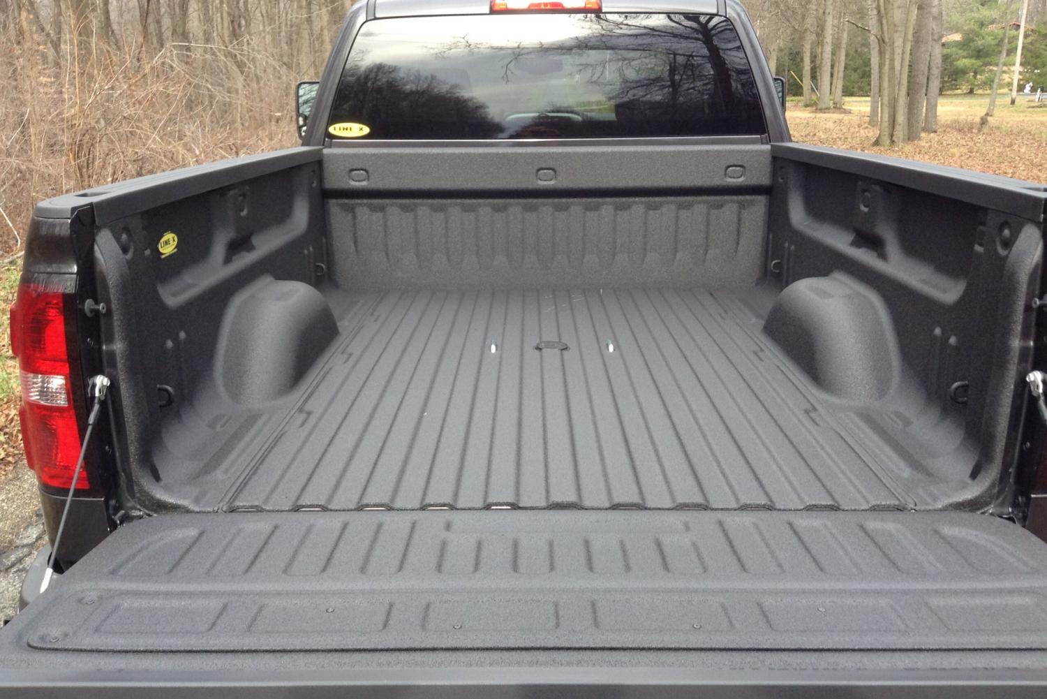

It was in fact an error in build site, I was able to get both the side steps and the curt gooseneck and nothing interfered with each other.
I did not get the factory bed liner because line x is thicker and I wanted the extra cushion. My only mistake was a lazy line x dealer that sprayed over all 9 bed plugs. I had originally hoped to remove and reinstall the plugs as needed with the removable tie downs just as you would from factory, but they have made that an impossibility now. I cut them out, but even if I reinstalled them it would take a beefy screwdriver or pick to grab them to remove. So I just cut the 4 corners out and stuck my toe downs in and there they'll staypost-143793-0-55793300-1453422415_thumb.jpg
