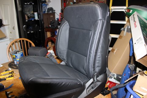

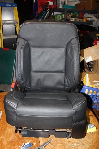

I'll see if I can attach a pic or two in a bit.

The center section of the seat looks pretty loose. Is it the picture that makes it look like that or is it pretty tight.
In my pictures, there was still some fluffing and pulling to do. Also it was about 30 degrees in that garage.... so the leather was really stiff. It tightened up nicely.

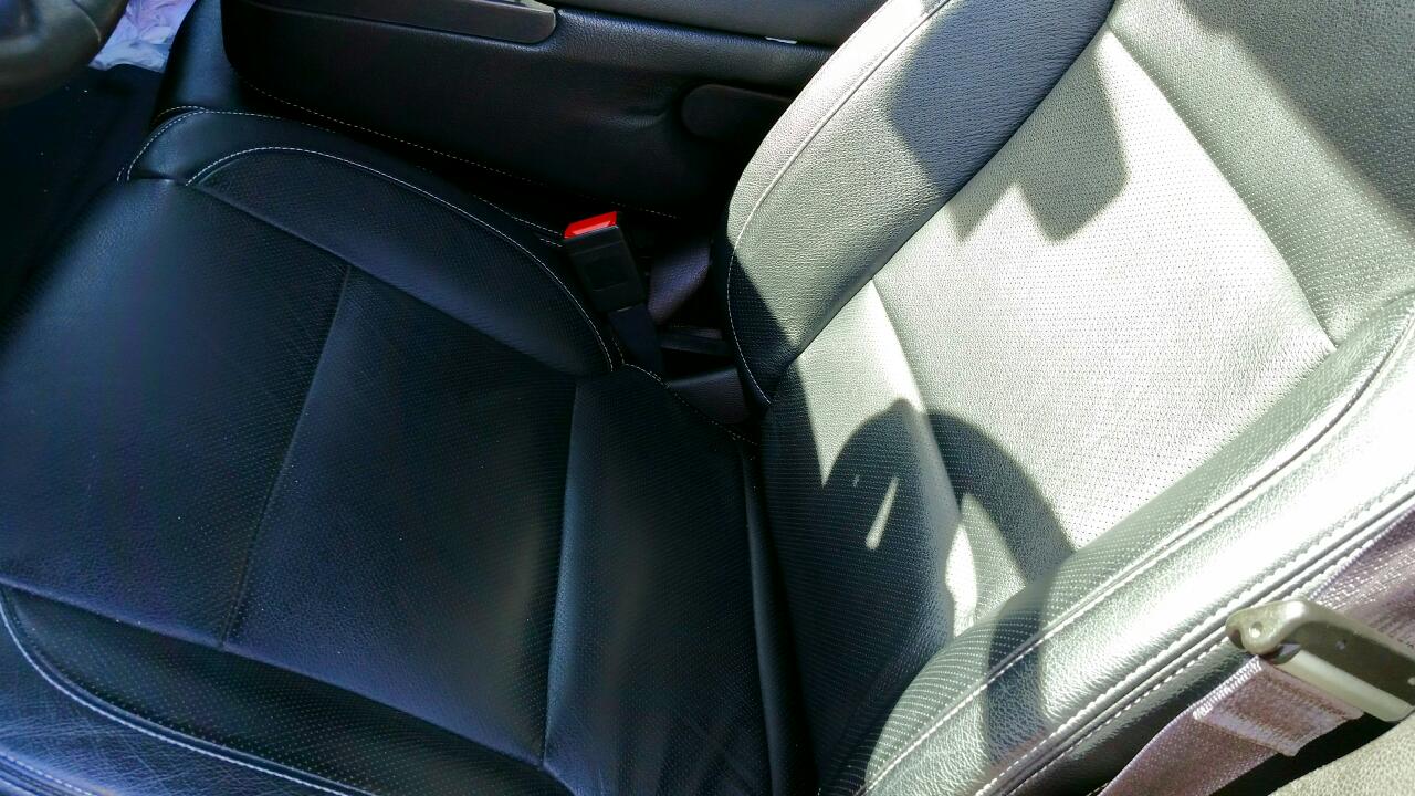

Can you post some recent pics. If you don' mind lol .
This is what it currently looks like, a year later.... multiple trips to the lake, off roading,and around 15000 miles of my fat but in it.
Damm they look good. Thanks for the pics bro.
