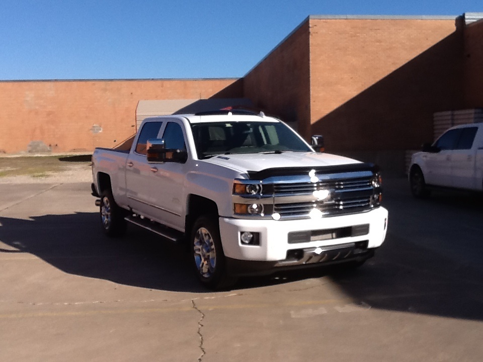

Update- New toy to haul the toy hauler, thread can die now,,lol thanks for all the advice
