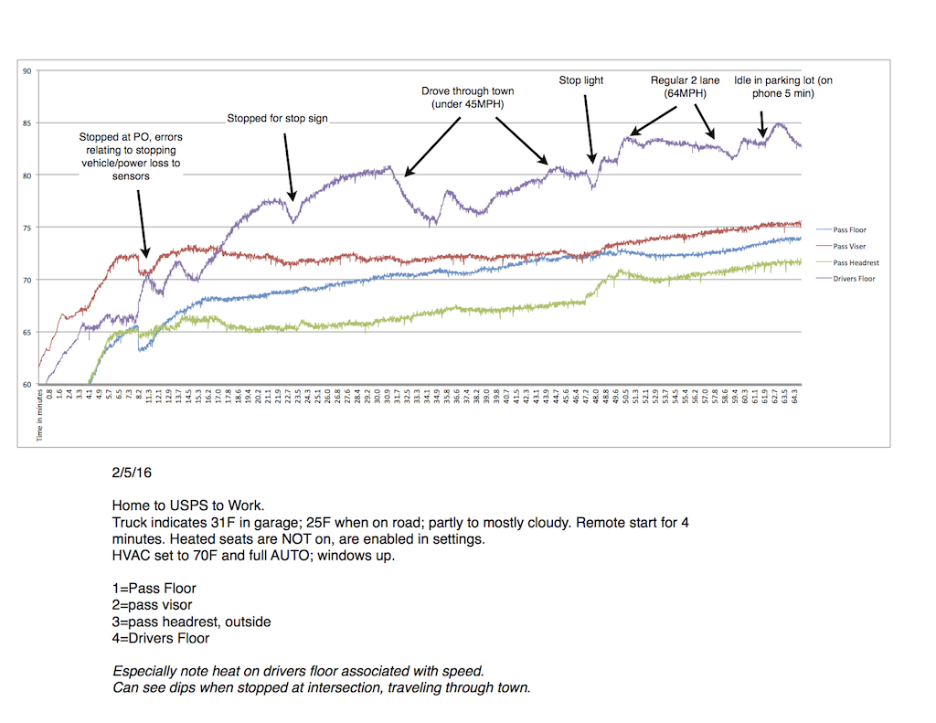

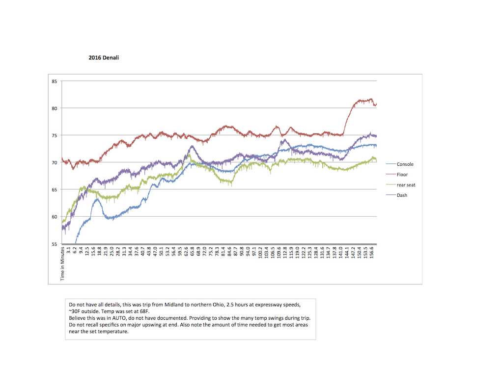

Following graph shows temps in the cab at various locations. I'm seeing wide swings on the drivers floor relating to vehicle speed. Dealer is planning to replace one sensor down there, but I'm wondering if it's something else. Is there a motor or diverter that is failing with higher vehicle speed (too much air pushing that door open or)?
For reference, here's what this truck was doing before they changed the temp/solar sensor. It's not a great comparison to the above as the test locations/conditions were not exactly the same, but the wild fluctuations are pretty visible throughout the truck:

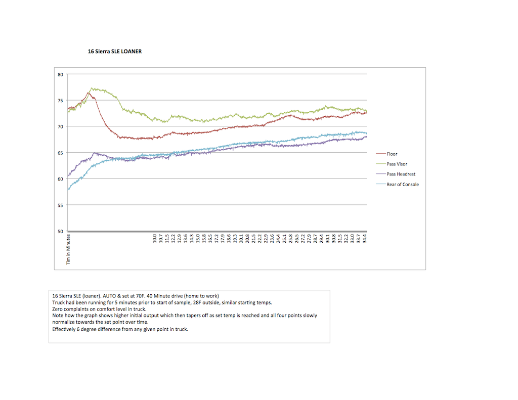

This is what I am comparing to, what I consider "normal". This is one of the loaner Sierra 1500s I was in (SLE trim). This compares exactly to the first graph above, same location/conditions/temp settings. Only difference is trim level and that's important because the SLE was buckets with the center jump seat, so no console separating drivers and passenger side.

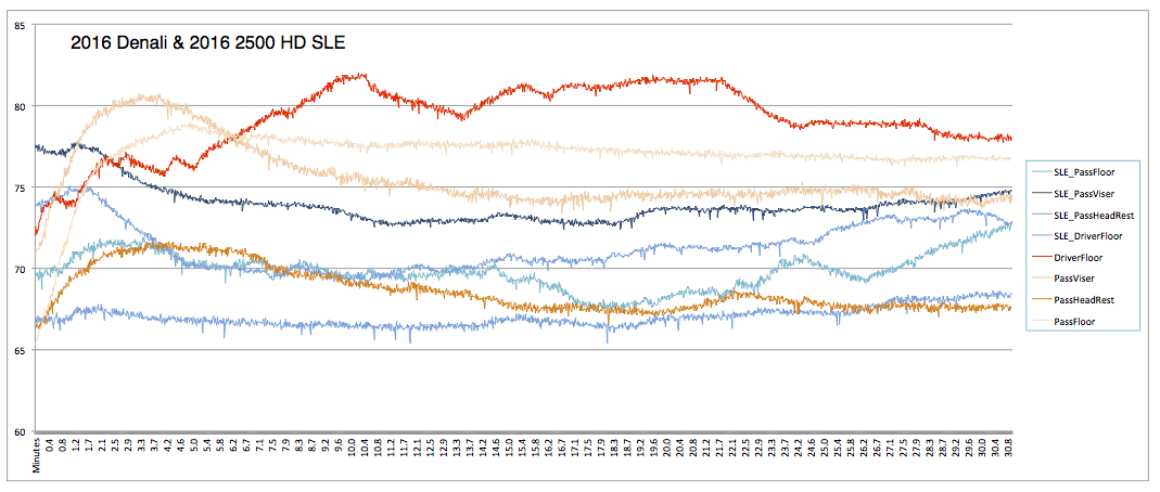

Just for reference, here's a graph showing a comparison of the 2500HD SLE and this Denali (see above post when we did this on a previous date).
Same outside conditions, vehicles driven back to back over the same roads, same speeds. It was highway speeds for 50% and then expressway speeds. Travel west, then north, then east and reverse.
Ignore the first ~7 minutes as the vehicles are getting up to temp and on the road.You can see a little fluctuation on the SLE for a couple of the temp points, but we're talking 3F changes, nothing notable. The Denali, on the other hand, is bumping around and going "way" high on the drivers floor with a much bigger overall difference between temps.
The SLE does not have a center console, while the Denali does, which they felt would make the issue act as it does. As they declined to drive the other Denali and I didn't have my instruments with me anyway, I don't know 100% if "they all do it" or not.

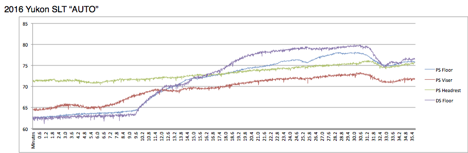

The Yukon was more "calm" than my Denali as far as rapid HVAC changes in AUTO mode in the 500 miles I put on it. However, it still did not perform as expected.
Here's a graph showing 70/AUTO and it's in the upper 40s outside. The start of the floor temp increase, at the 9 minute mark, happens when we change from east to north (it's 11AM) which changes the amount of sun hitting the solar sensor. The drop at the 31 minute mark is me clicking it from 70 to 69 (my feet were getting uncomfortable).

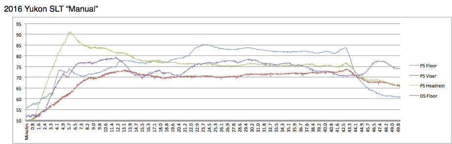

Below is the same Yukon, on a different day, with 4 occupants and we tried MANUAL mode. Set it to floor and defrost, 69F and second to lowest fan speed. I didn't document the rear HVAC settings, but they appeared to be mimicking the main settings. It's 30F outside, bright, light snow. Note the drop at the 42 minute mark on the PS Floor - Passenger changed the setting for their side from 69 to 65 as they couldn't stand the heat on them any longer. Can't blame them, they had 92F blowing on their face 5 minutes into this ride.
Looking at the graph, you can see the only thing remotely close to the number we had it set to was the ceiling (passenger visor).

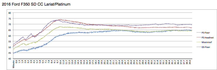

Here's a recording in manual mode, 30F outside, set to 68F inside, sync'd, manually set to floor and defrost, lowest fan speed. Most of the previous graphs give an 5 minute warm up before the recording starts, this one is from a dead cold start, so we show a longer and more dramatic warm-up ramp on the graph. The drive is the same route that most of the runs on the Denali were recorded at, so I'm very familiar with what could be happening and when, as far as speed/direction/sun load.
Far as I know, the Ford has an active temperature reading during operation and adjusts accordingly. This would be very similar to my 2012 GMC, but not like the 14 and up GMs (or maybe just 16, I was told by the Tech that 14 made the change). 14 and up, GM does not actively check the temp in the vehicle (one reading at start and then no more) and does it all "on an algorithm" which is really what I see and feel happening.
