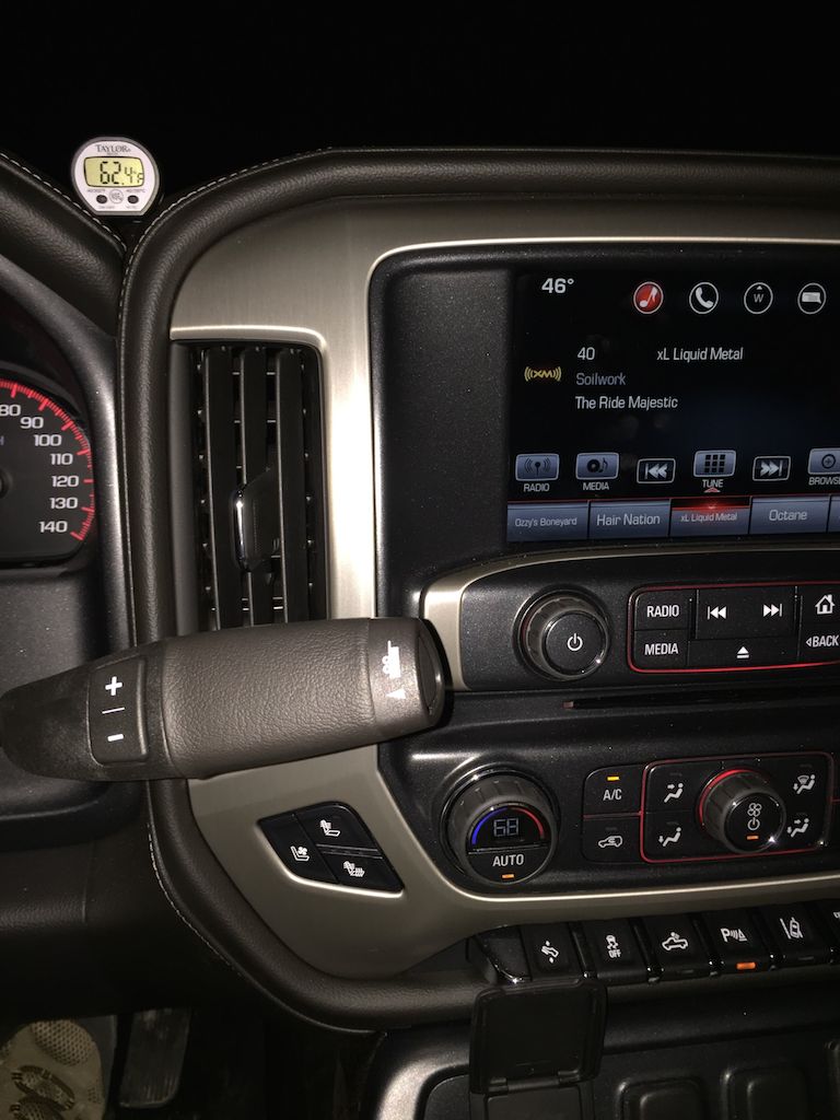

2 thermometers in the truck, one on the console in the wireless charging spot and the other on top of the dash just left of center.
In AUTO mode, set to 68F. 38F outside temp, no sun. 45 minute trip on rural 2 lane, average 62MPH.
Temp reading from dash thermometer was down to 59F, one on the console was 64F. This was at the end of the trip. Both started out a bit warmer, the dash thermometer was ~63 when I started the trip.
My feet were starting to feel cold. I had redirected the dash vents so they were not blowing directly on me, which seemed to help me feel not as cold overall.

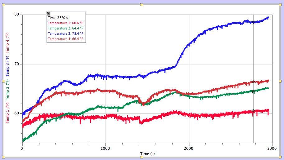

I'm still doing data collection over longer periods of time (have 4 temp probes set up with laptop doing collection), but what I've seen for sure, is in AUTO mode, the truck usually puts heat out on the floor and the temp down on my feet will increase by 10F when adjusting the dial one degree. It stays at that elevated temp until the dial is adjusted. I haven't done enough testing to give more solid info (does it increase/decrease linearly, etc.).
See the attached graph for an example (1000 seconds = 16 minutes). I'm running in full Auto mode at 68. Feels drafty around my upper body, so I click the temp from 68 to 69 at around the 1900 second mark, where the temp spike happens. The temp at my feet jumps 10F (78F) and continues to climb slowly until the end of the trip. The temps being monitored on the graph are dash, console, floor and rear seat. Not worth reading too much into this one graph on all the readings, other than to show what the floor temp is doing. This seems to explain why it goes from feeling cold to "too hot".
