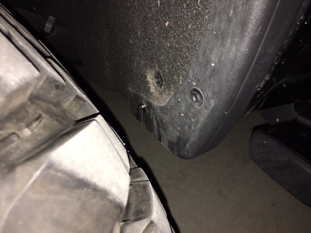

Here is where its rubbing, where the bottom screw is in the picture. Also rubs a little bit when i take big dips at an angle. Hope I get to take this thing off road one day. And the tires do not stick out too much, Maybe 1-1/2".
Well from the looks of it, its trim or go higher... I personally would trim, as u already are on a 6" lift. Im sure you could trim with a dremel, them sand and polish the rough edge left behind, and no one would be the wiser
Ok think i'm just gonna trim, Thanks for all the advice.

Just have the shop that lifted the truck trim it. As long as they know what they are doing you won't even be able to tell anything was trimmed.

All of the 6" Fabtech lift kits say you can fit a 20x9" wheel with 5" backspacing and 35x12.5R20 with minor trimming. So that'll be the answer you get if they even have an answer. In your case you be able to just cut the plastic corner piece and then zip tie the wheel liner back and be set.
I have a similar setup to you. 6 inch Fabtech with 35 tires. Coming in and out of the driveway is a slight rub, but it is not damaging just slight rubbing so I'll probably just live with it for now.
Mind did the same thing, just beat on that inner corner with a mallet or hammer, that will/should push it back far enough to get rid of the rubbing when you turn the wheels. If you want it to completely go away then you are gonna have to trim it up back there.
Mine looked exactly like that.
I trimmed the plastic and about 2"s of metal upwards 1" of metal backwards behind the plastic/screw. The reason i went so far back was that if i were ever in a situation in full lock and the struts fully compressed (not sure what type of situation that would be) the tires would still clear. I also had to zip tie the front liner. The rubbing wasnt as bad in the front but bothered me enough to do something about it. Ill take some pictures here in a little while.
