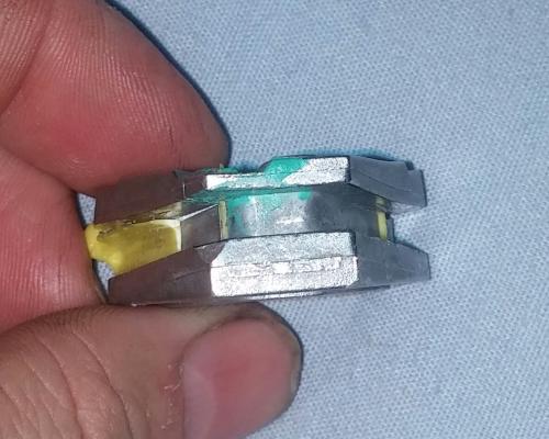

I need some help. I have these 2 guides from the steering column that are cracked and i dont know what they are called nor can i find a part # for them. Any help would be appreciated.post-153169-0-88258600-1454104284_thumb.jpgpost-153169-0-12833400-1454104309_thumb.jpg
Well, nothing like that in the breakdown. Looks like the whole column would need to be ordered to remedy the situation. Part not sold separately
So are these are not in the column? but rather under the dash?
The bolts that hold the column up under the dash go through these guides and the column slides into these, then the nuts get tightened.
Doesn't look like it's a separate part. No individual part #, but see them in the first PDF
