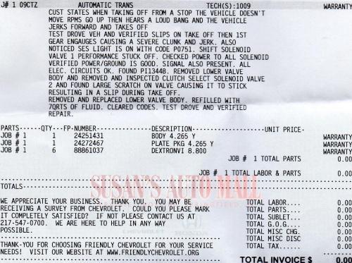

Picked up my truck yesterday after it spent 10 days at the dealership. They told me it took some time to find the parts. So far no problems. See attachment for details of work performed..post-156162-0-37307400-1459352249_thumb.jpgpost-156162-0-37307400-1459352249_thumb.jpg
