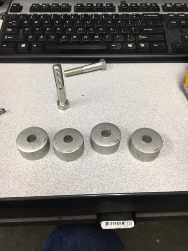

ground up, here are the first set of spacers I made. punched them out of aluminum. Not dead nuts but close.

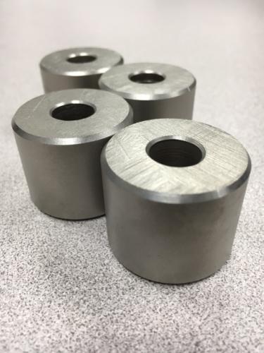

I fabbed new stainless spacers this morning using the mill and lathe, so these are dead nuts 1" thick. I will install and have aligned then measure with an empty tank to see if it changes at all.
