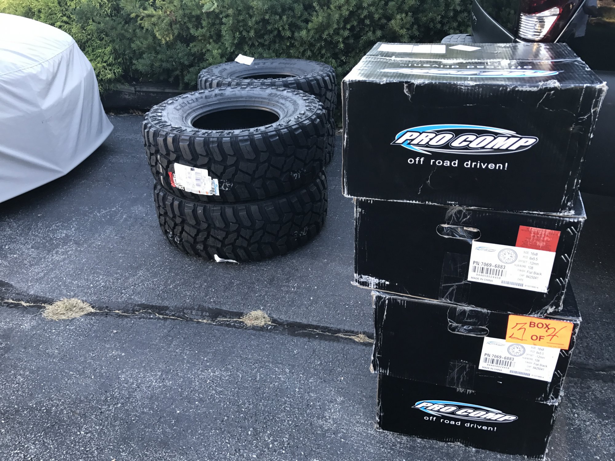

anyway I got some new wheels and tires last fall.
more pics to come...
