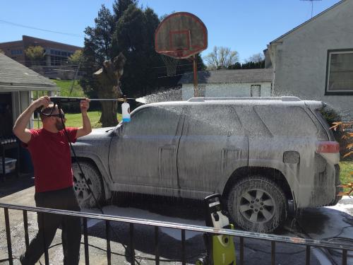

A pic of that step up foaming my wifes 4runner
Sweet will do. You need to hit that basketball hoop next! :crackup:
What's your process when using the foam cannon?
The basketball hoop is gone now. I spray wheel wells first with pressure washer and then foam the vehicle and the wash with a pad.
