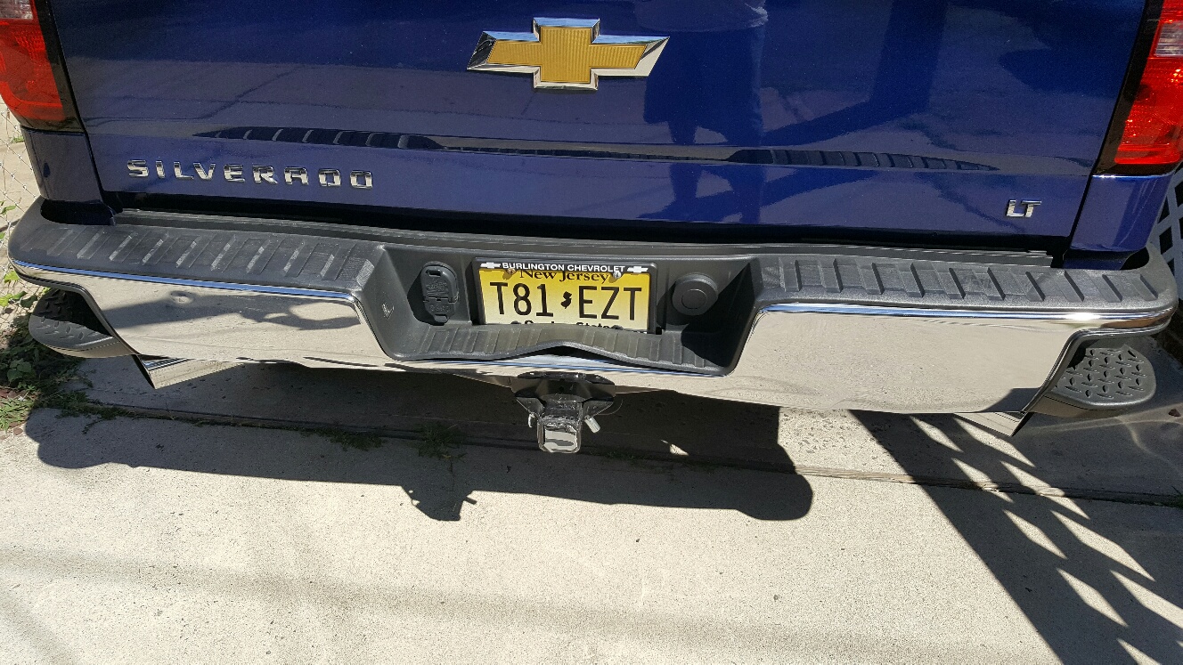

Well got rear ended this past weekend while on a trip to the beach with the family. I took the truck over to body shop for an estimate on the damage.
Basically the hitch got pushed down and in, bending the frame with it behind the hitch mounting locations. The estimator said they can pull that right out. Everything i have searched says you cant pull on these new GM frames or they become unsafe.
I was quoted under 3 grand in repairs wich include replacing front and rear bumpers/ brackets, hitch and pulling the frame, also a 4 wheel alignment. The frame is def bent but nothing crazy. Does this all sound right.
Sounds reasonable.. but don't be afraid to get a second opinion from somewhere else. In fact, I recommend it.

^ The bed looks fine the tailgate also looks good. All the body lines look straight and the gap around the bed and cab measures out the same one side to the other. Most of the damage looks confined to the rear bumper and hitch, especially where the hitch mounts to the frame. Behind of the leaf spring mounts the frame is bent.
I scheduled a second estimate, we'll see and compare. Also submitted a diminished value claim, funny how companies turn clueless when you bring that up.
