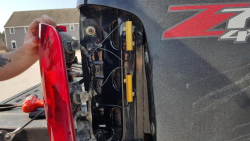

We've had great luck with the Sylvania Load Equalizers
https://amzn.com/B01A77U122
Each LED bulb has two wires coming from it in my tails, so 4 total wires.
Would one need 4 of those resistors per tail light in this scenario?
Sent from my SM-G930V using Tapatalk
One resister per bulb.

I only used 1 50W 3ohm on each tail light on my LED conversion. I believe if you use 50w 6ohm you'll need 2 on each but if you use 50w 3ohm you can get away with 1.
