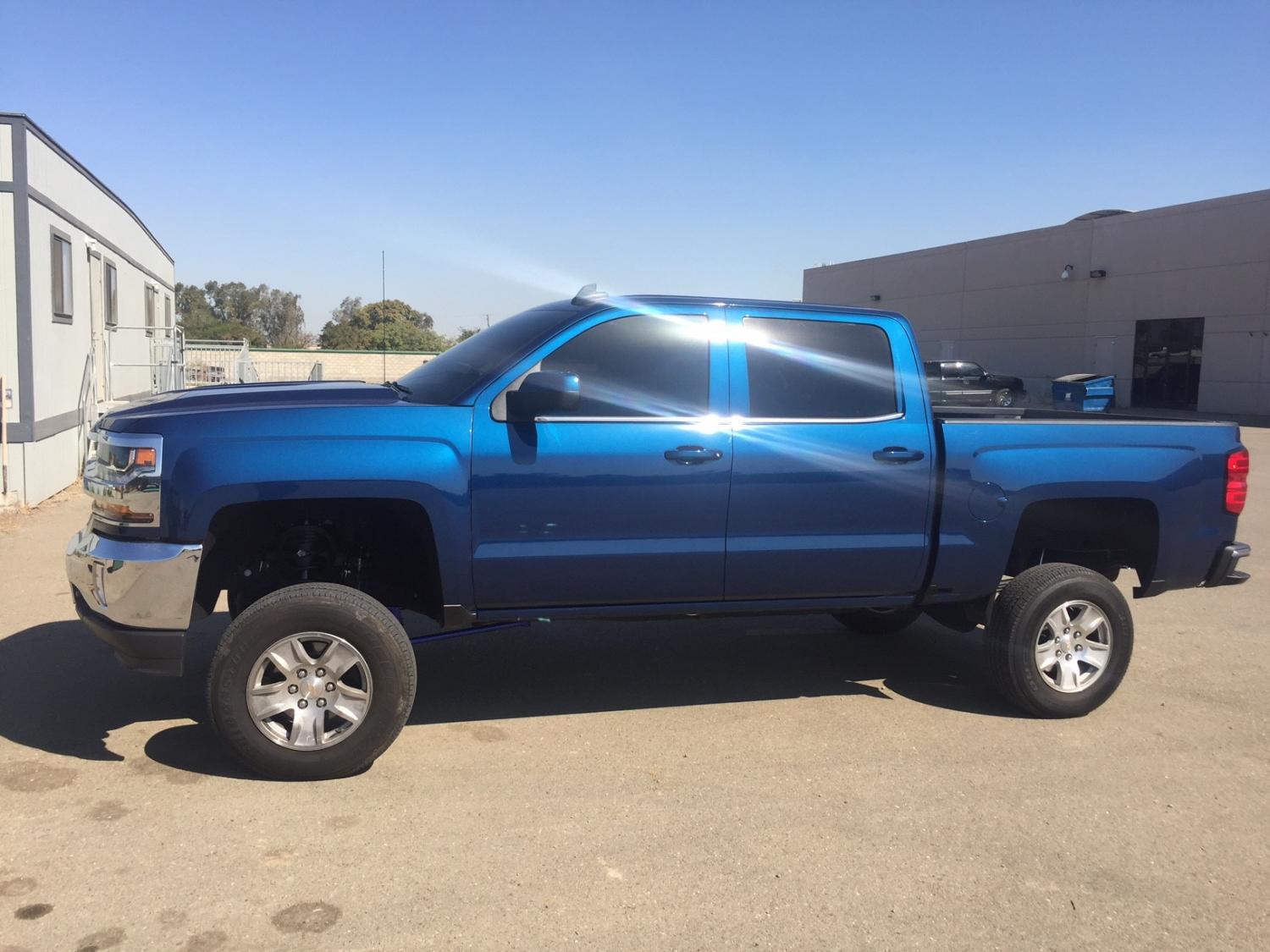

The lift turned out great, I'm really happy with it and it rides nice. I'd like to look in to new control arms in the near future.
This picture shows the lift, you can see a little of the powder coat, the tint and the LTZ window trim pieces that were added.
