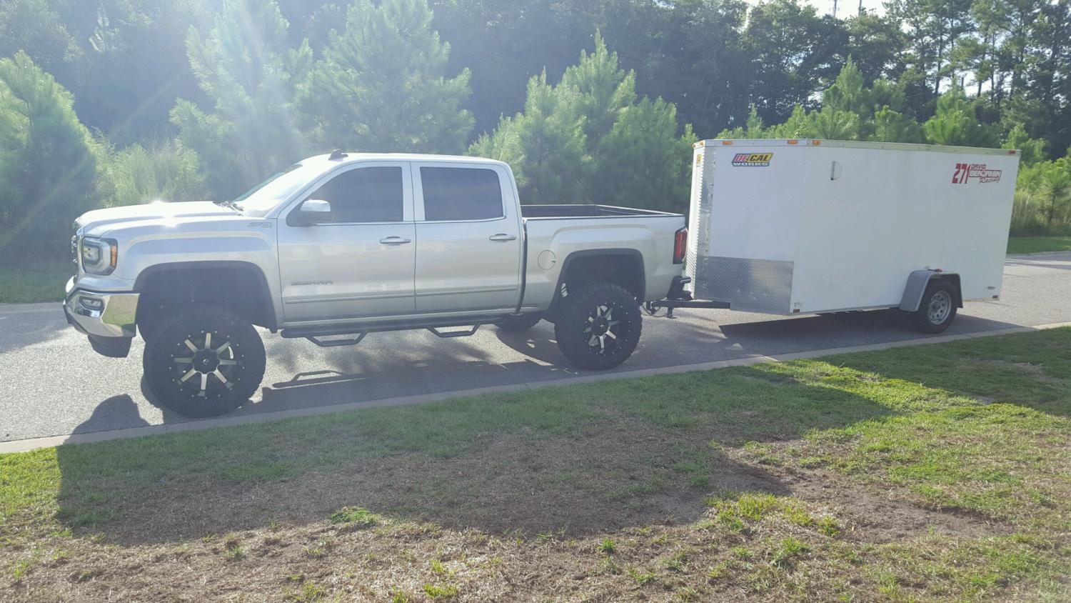

Yes, your pic. While the squat is not bad you can see the front end has lifted up some as well. That is the only downside to leveling these trucks as it will put the projector cutoff right in oncoming traffics eyes if you have anything in the bed or on the hitch towing.
It may be an inch lower in the rear if that when loaded with my enclosed trailer. Ive adjusted the headlights down anyway when I lifted it, ive never been flashed at night time with my truck loaded or unloaded. I got the hitch in yesterday and its night and day difference towing now. Its 1.5 in higher at the tongue so maybe that helped it out.
I have a 2014 lift led 6" on 35s. Don't have this issue when towing 5k lbs+ boat. Breaking isn't as great as it used to be but still works fine.
I love guys that lift their trucks 4+ inches and then complain when it will not tow well...
Visit a scale and check the axle weights - weight distribution is key to successful and SAFE towing.
