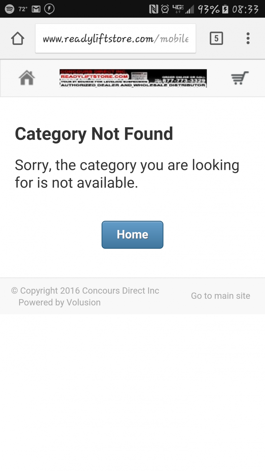

Does this kit account for having tow pkg? I believe the replacement "U" bolts have to be wider. That is something that you need to know if applicable. That is why I am going with this kit. It has more parts to keep everything factory correct. I will be opting for fox shocks all around as well. The tech guy at RL told me I could get almost 4" if i wanted, but I was going to keep it around 3". And I am keeping rake before you ask, because I tow a trailer..and i like the look as well.
http://www.readyliftstore.com/SearchResults.asp?Search=69-3422&Search.x=26&Search.y=16

Cant see which kit you are referencing..
Readylift 69-3422
