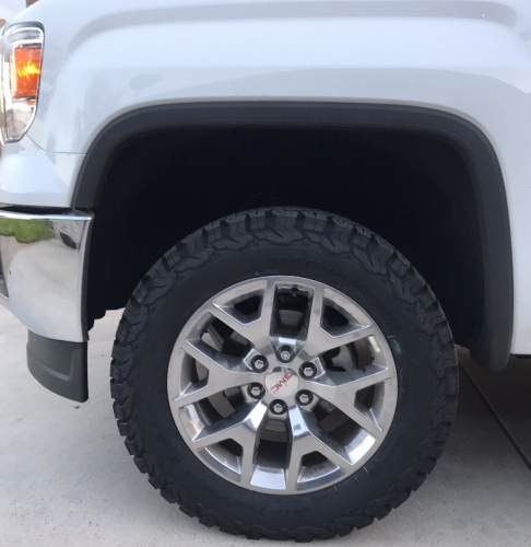

Works and looks great. Smooth, no rubbing or trimming since BF KO2's run a bit narrower. Great deal at Costco, $329 each or $1495 out the door. Running a 2.25" Procomp leveling kit in the front only.
For comparison, here is a KO2 in 275/60R20 on the factory wheels with a CCM leveling kit. These tires are approx 1" taller than the stock 265/60R20...
No rub either...
305/55/R20:
The flares had to be shaved down just a bit (maybe 1/4") to avoid any scrubbing on turns. I'm very happy with the work done. They fill the void in the wheel wells a bit better now.
