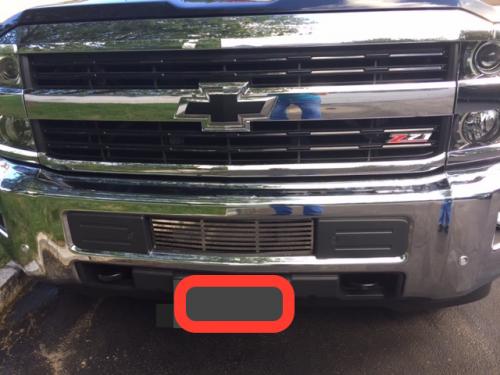

I put this Stainless Steel Transmission Cooler - Bar Design Bumper Grille Cover manufactured by
"PUTCO" on my '16 Chevrolet Z71 - LTZ Silverado HD - Duramax - Part Number: 86195
I'm hoping the tranny does not run hot with it on. Anyone have any first hand experience running with one? Additionally I installed it not so much for the looks but more for practicallity to prevent stones, rock salt and the like from damaging the fins / coils.

I put on a Putco screen on mine within a week of buying my 2015. I run a lot of gravel roads, and that last thing I needed was to have someone come by me from the opposite direction and happen to get a rock thru there into the oil cooler. Really lame that GM didn't have some form of screen or grill over that lower opening. Not sure where R&D's mindset was on forgetting to protect the cooler.

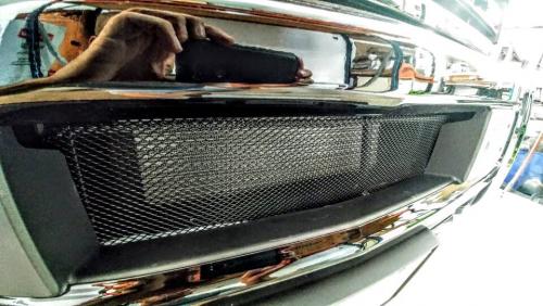

Open the pic w/ Paint, you can resize it to a more manageable size.
$1.50 black coated metal gutter guard. Trim the length a few inches and slid between the plastic bumper trim and bumper. Just to protect from rocks. Quick, cheap, easy. It stays put and hasn't moved for the two months I have had it in there.

Could you take a pic of it taken a few feet away from the truck?
