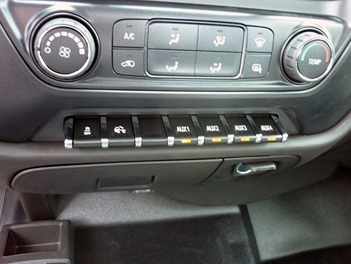

Hello all, sorry if this is a repeat question, but I am looking at adding a Light Bar to my truck and I am now looking at switches for inside the cab. I am pretty sure I saw somewhere that there was a custom switches under the air conditioning controls, in the same area as the traction control on and off switch.
Any advice would be greatly appreciated!
if you have a lt this is what you want, you can use the aux switches to control the ground on a relay for your light bar
Yes that is exactly what I was looking for! Can you tell me where you got it? And what it's called... I have met been able to find it.

I thought a good place to mount a switch is on that panel. Flush mount push button mounted to the bottom of the first button on the left. My truck is an LT so they are larger and the first spot is blank.

It's a gm multifunction switch from a dealer. You just have to find the right options and with the aux switches. Here is a screenshot from a thread I found a while back with part numbers. I can't remember what the thread was called but they talk about it in depth. Just make sure it has the factory options your truck does. My truck is an ltz so I had to modify and use a matching relay module to use one of the momentary switches to get it working.
I'm just a little confused about how to hook the switch up. Any advice?
