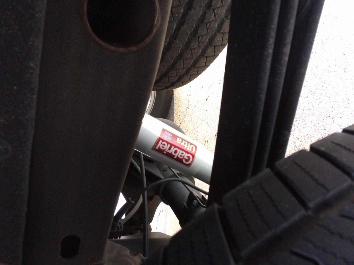

Pics are of the factory Ranchos on my 2014 SLT at approx 50,000 miles. I think they were actually bad at around 25,000 miles, not impressed by the Ranchos!. Put on some Gabriel Ultras on the back (20 bucks each delivered) rode much better never messed with front ones and traded the truck.post-127028-0-47197300-1460675416_thumb.jpg
