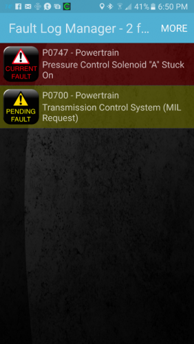

So it's going to the dealership in the morning to find out what's wrong. The truck is a 2017 Ltz Z71 6.2 w/8 speed. Only has 7500 miles. I was stopped at a red light waiting to make a right turn and when I did the only thing moving was my rpms. I thought my truck somehow ended up in neutral but it wasn't. Let off the gas and tried it again, same thing. Rpms just went up to 4k. After the 3rd try I guess it went into a gear. Not really sure which one but it hit so hard it made the whole truck shake. I expected to see a puddle of trans fluid behind be after it started moving. It had to either be 1st or 2nd gear, but it wouldn't shift out of it. I had to limp it at 4k rpm to a parking lot. Turned the truck off, waited about 10 mins, and started it again. Now it got me home, but the 1st couple of gears shifts really hard. I scanned it with torque once I got it home and there's 2 codes. P0747 and P0700. I've attached a pic with the details. I'll keep everyone posted on what the service dept says. Hopefully it's a quick fix or that they have a new trans in stock. I need my truck this weekend to go out of town.post-54656-148885709636_thumb.png

huntr1117, please make sure your dealer is aware of service bulletin 16-NA-404, it was published in December 2016 and describes reprogramming the TCM for P0747 (P0700 is just the TCM telling the ECM turn turn on the MIL). Reprogramming should resolve the P0747.
