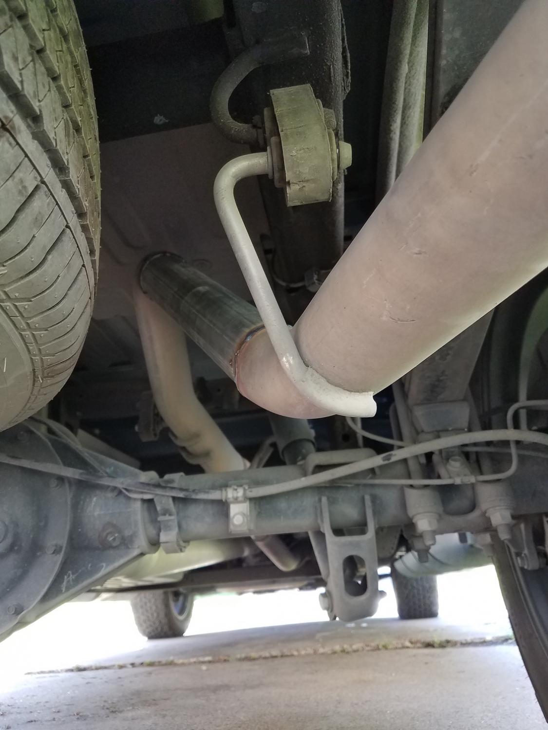

The way I have mine in don't hear the chop. Or its very very faint. I don't have a flapper but I left the resonator. It's absolutely perfect

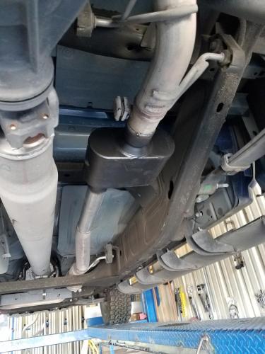

I just did mine this weekend. Had the Flowmaster Super 10 installed, resonator removed and the flapper tacked in the open position. Sounds good to me, drone isn't too bad or hardly noticeable at all to me. I like it.
