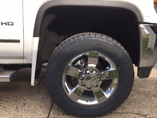

Mine are a bit bigger 285/65/20 (34.6-11.3-7.3 sidewall). They are on stock rims and is leveled. I would bet yours will fit fine, mine would without the leveling. Here is a front pic.
Thanks for the responses. I think I'm going to go aftermarket simply for the wider wheel. 7.5" wide is going to ballon the tire I feel. Maybe bell tire will let me do a test fit
7.5 is a little narrow, mine are 8.5, I was really surprised at the width, we measured it with the tire off inside to inside. When I first saw the rim on the stand I wished mine were that wide and it was Mine! I thought they would Ballon out but they don't, I almost went with the 295 but I was afraid it would balloon. I was looking for bigger but not too big and these tires fill up the wheel well and you can't make them rub, not even full crank going in a big curb entrance. Some day I will change rims but these work fine and I like the looks.....and 4 of these tires is enough $$ now.
