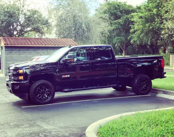

pics before and after lift?

Gotta figure out how to reduce photos on my iPhone. Can anyone tell me the max photo size I haven't looked into it yet but I would like to post photos
