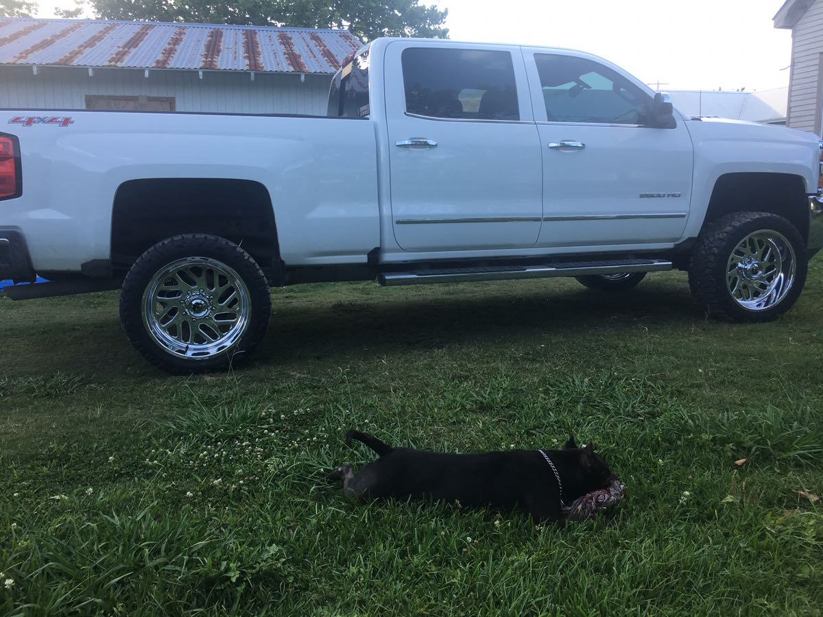

I was able to fit 33x12.5 with a -24 offset without any mods with this setup. Ride is a bit stiffer with the heavier wheels but not bad overall.

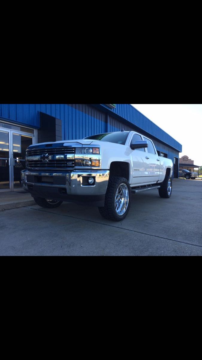

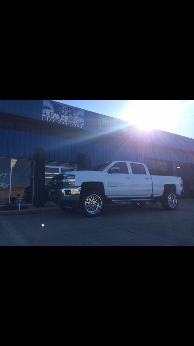

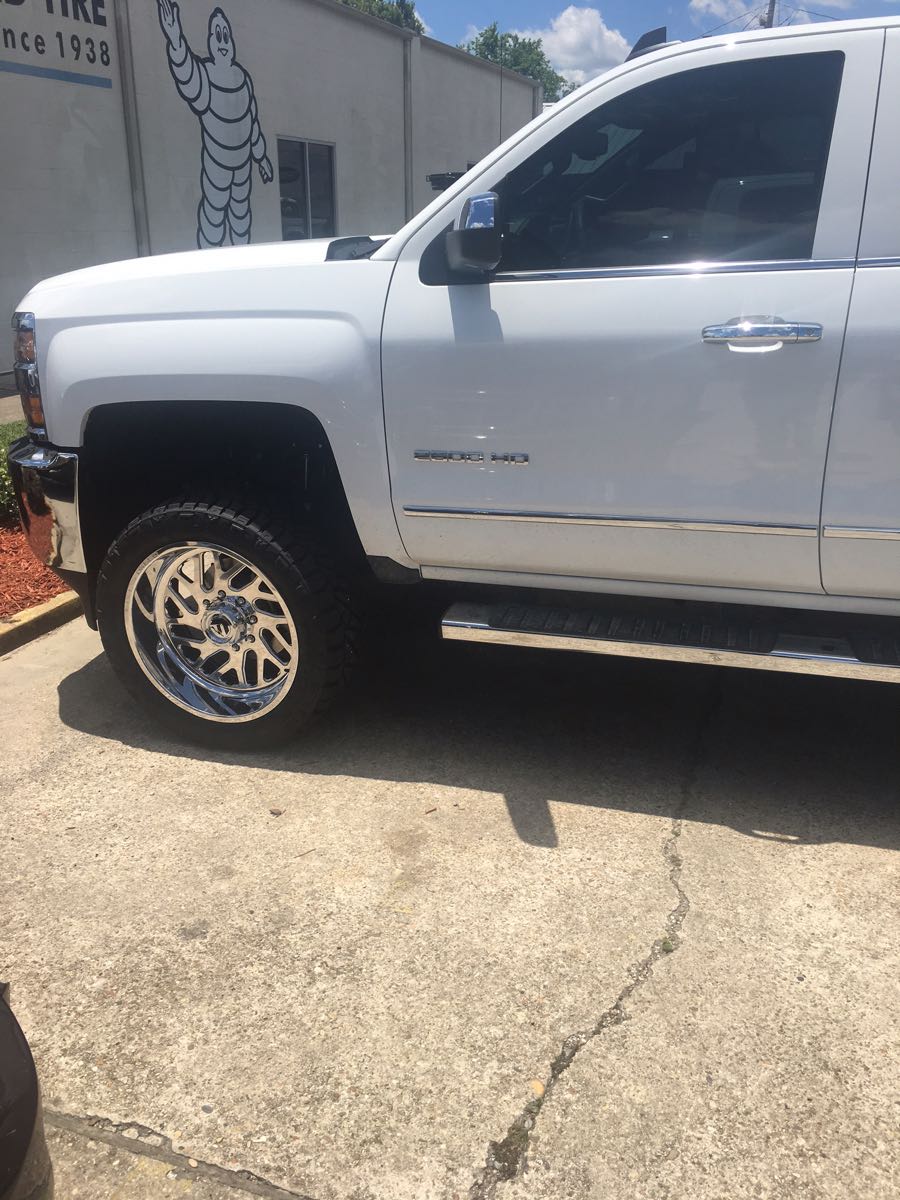

Ended up going with 20x10 Fuel Sledge -18 with 295/55/20 Nitto Trail Grapplers.
Perfect fit, just barley rubbed the felt splash guard on one side at full turn, pulled it back with a zip tie.

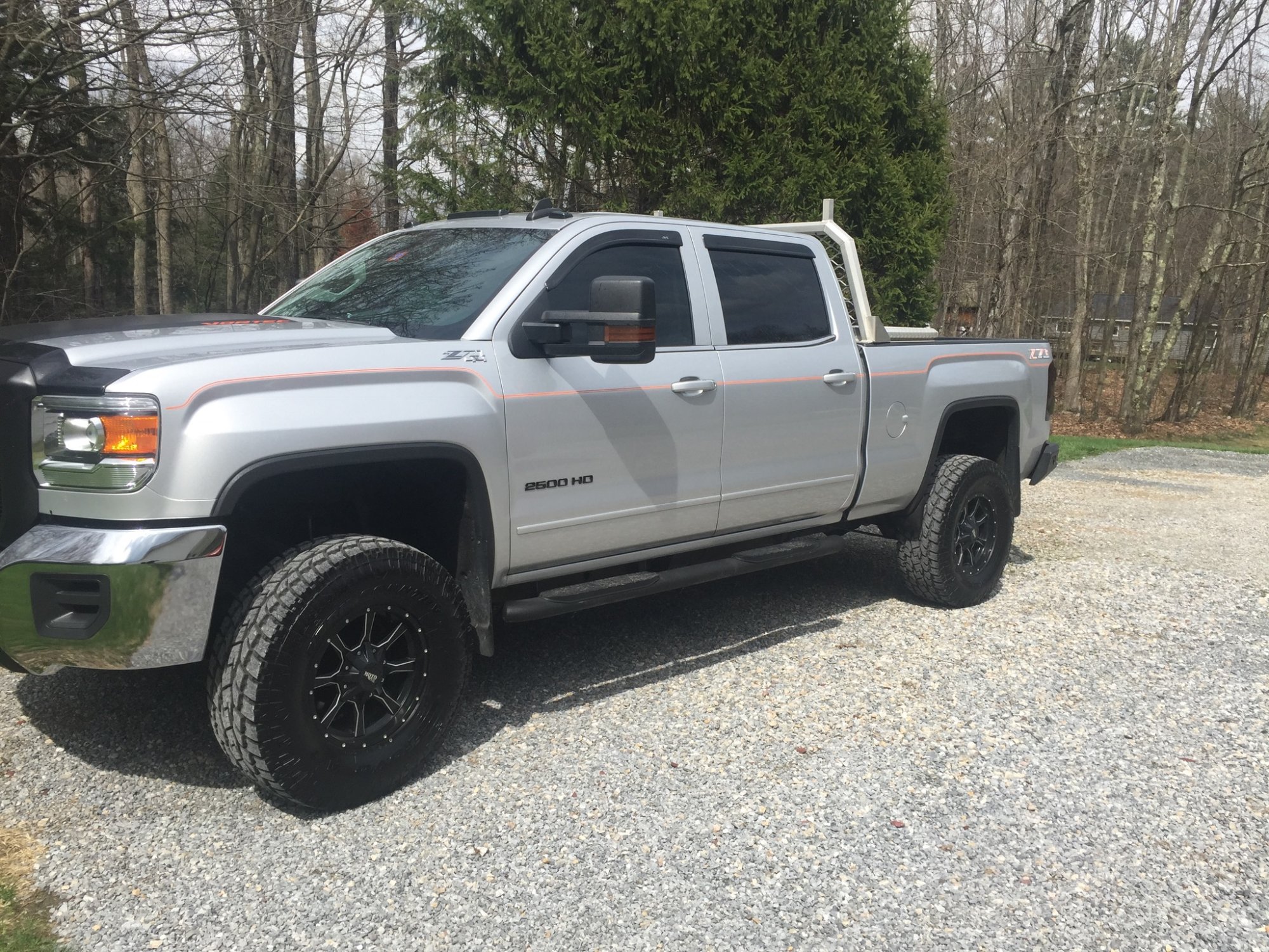

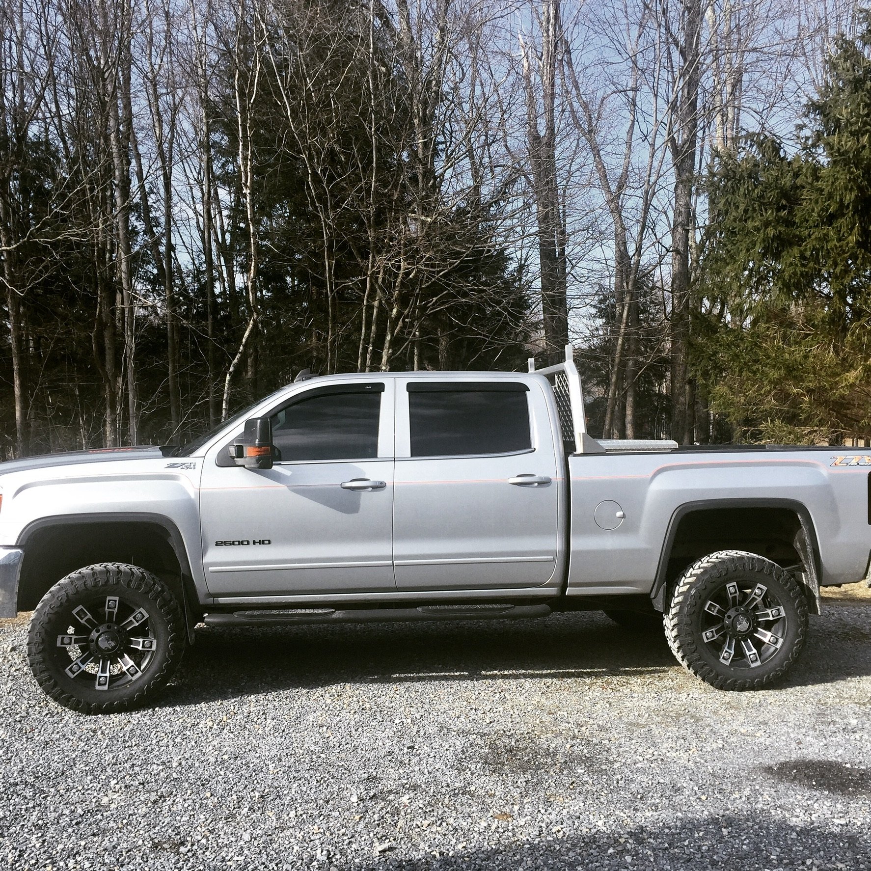

My 3.5 inch kit with 35s
This looks sooooooo good!! ?
