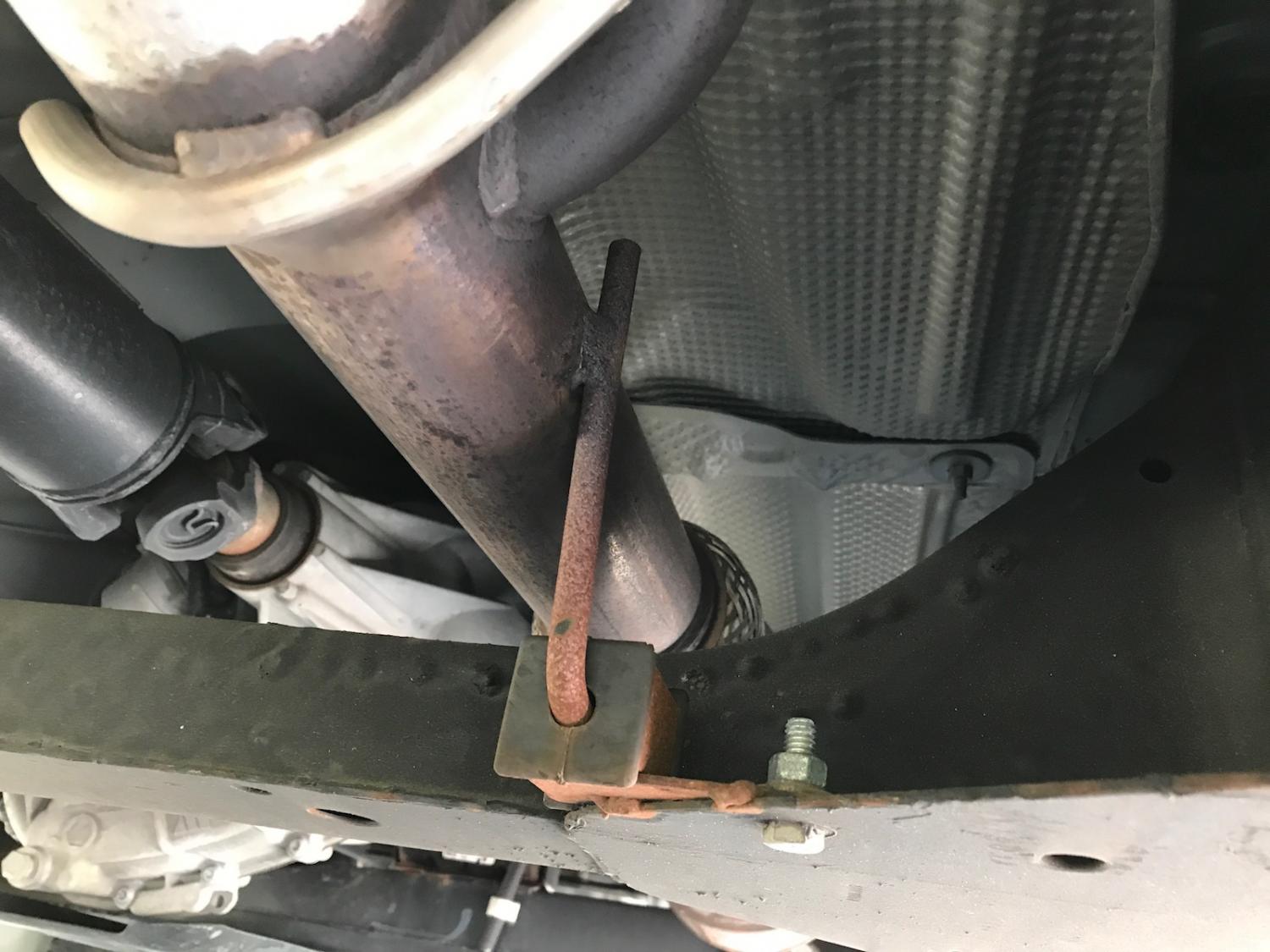

My GM Borla Exhaust was making a sound also like it was rattling or something. I found that the straight pipe after the flex section at the front was hanging low and hitting the cross member. This was causing a rattling type or bagging sound. Went to a Midas and for $50 bucks the welded on a rod with a built in rubber mount and bolted it a hole near that cross member and the add a couple of tack welds. I haven't heard any strange noise's from the exhaust since then.

At the time of the video my front pipe had a good half inch of clearance over the frame so it isn't that unfortunately.

Here is the pic of the extra support bar I had Midas put on my GM Borla exhaust. Its the bar attached to the side of the exhaust that goes to a square rubber boot and then the bolt to frame.
