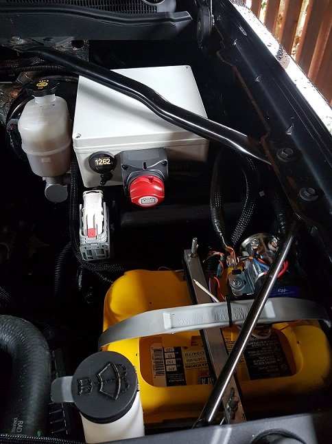

Added a second battery with 200amp smart isolator with a distribution box that has it's own battery switch and voltmeter for all the accessories I've added and for future ones . The box holds a fuse block , a shunt for power management meter , and a resettable breaker . I have since added an Anderson connector for a 1500 watt inverter/jumper cables , and the parallel switch for the isolator .

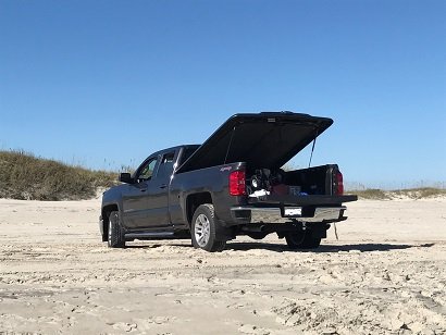

We took the truck for a week in Ocracoke NC (We love this place) and it ran great on the beach in 4WD .
