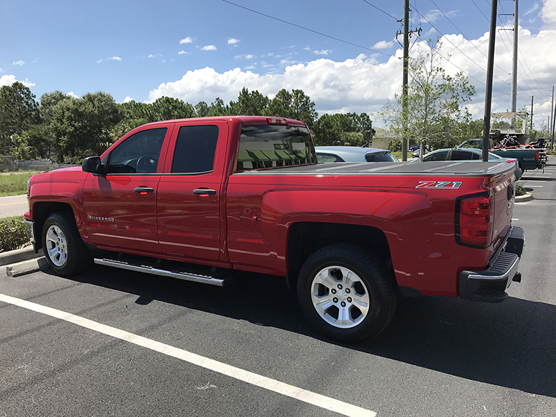

Just bought a 14 Silverado 1500 LT Dbl Cap Z71, still has Z71 rims and dealer put brand new wrangler tires on it. I rather look for a machined glossy black finish rims and tires package where it can fit and look nice. The tires I would like to get more of AT look, so please suggest which ones would look good. I dont want to raise the truck, but if I change to wider tires (currently fitted with 265/65R18) and keep rim size the same, do I need to raise the front to avoid any rubbing?

If you don't want to lift the truck, then stay with a highly positive offset on your new rims (+12mm offset or higher). And, for tire sizes, a 275/65/18 should fit without any trouble. You may also be able to clear a 275/70/18 or 285/65/18, but that may require a leveling kit or trimming/pulling the fender liners back with zip ties.
What would be considered a simple leveling kit? Fronts of 2"?
Thanks for the help.
yes. Most people run either 2" or 2.5". I would say 2".
