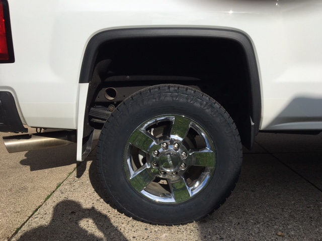

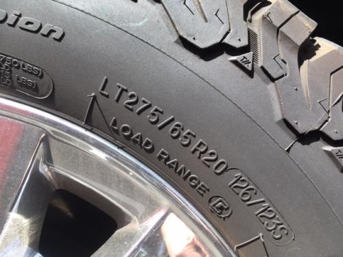

Don't have comparison pics, but here is what the KO2 in a 275/65R20 looks like on the 2500...

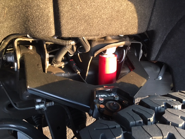

I'm running a Central Coast Motorsports leveling kit. It consists of new Upper Control Arms, Diff Drop Spacers, Torsion Bar Keys, and Shock Extenders. They are a small shop in San Luis Obispo, Ca. and fabricate their own lift kits / leveling kits which keeps their cost down. Torsion bars are cranked to achieve a slightly less than level stance. The ride did stiffen a little, but it is more truck like as opposed to the very soft stock front end feel. Check out ccmoffroad.com for more details. Pics below of the components...

UCAs and Diff Drop Spacers (sideways view...truck is not on it's side...ha, ha)

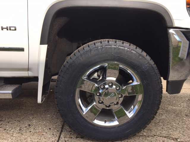

I have the 285 65 20, it fits perfect with no rubbing ever. I can't compare but here is what mine looks like.
