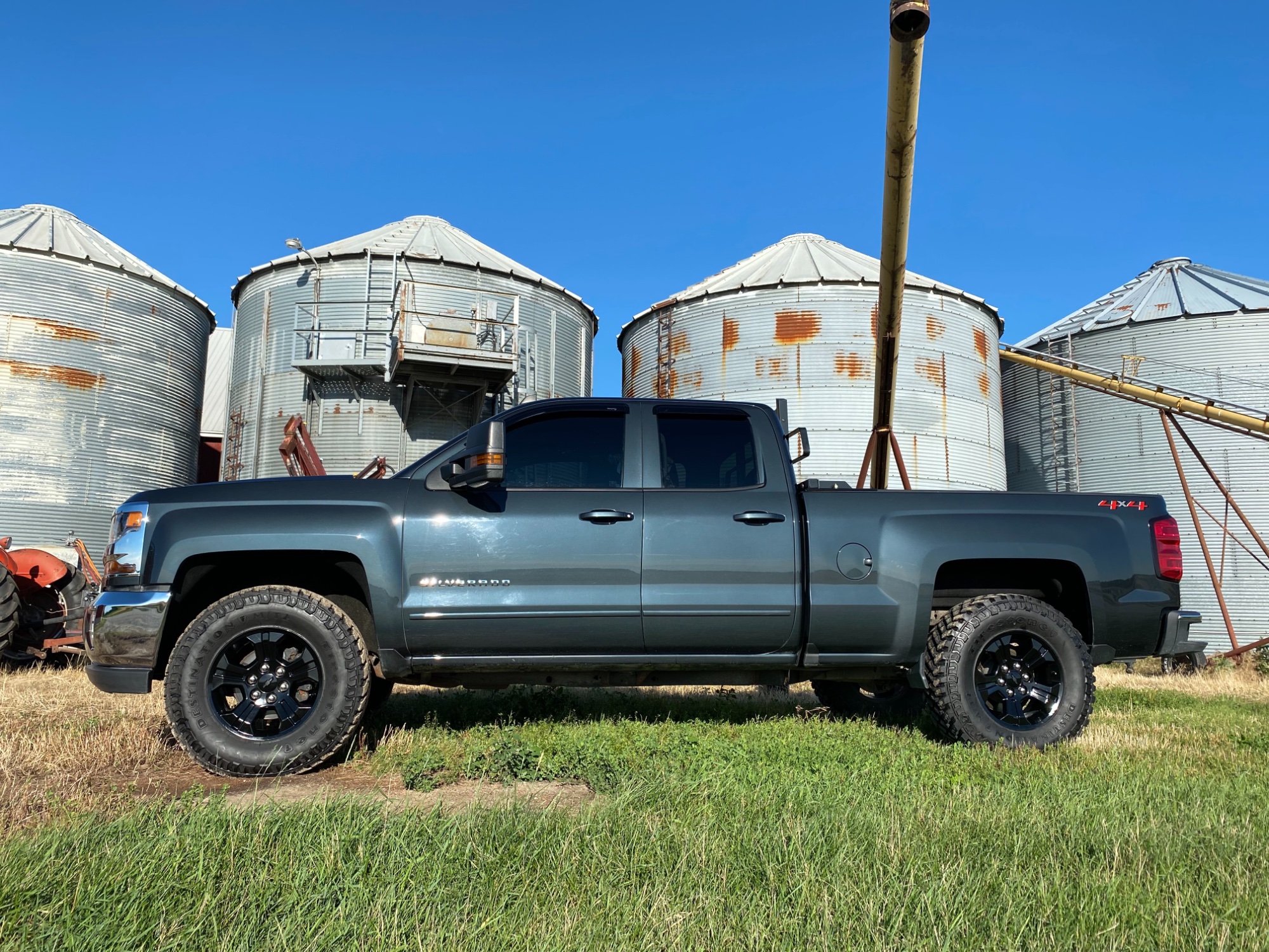

I have a 2019LD Silverado 1500, with just a 2” level up front. Running stock z71 wheels, which I would assume have the same offset as your wheels. Have 295/70/18 Firestone mud terrains. No issues rubbing and you still have full off road capabilities. People will doubt it 100% but they fit and function same as stock tires
