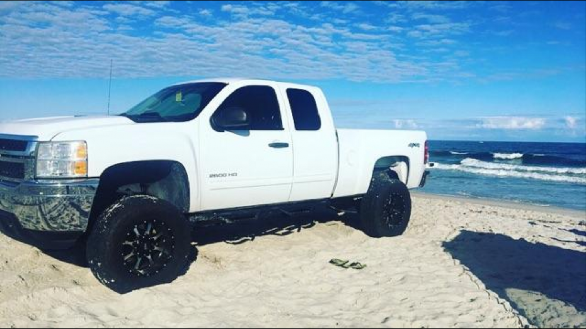

Just an update I bought the 5 inch zone lift kit. Ive had it on the truck for about a year now and I have no regrets! Some of my steering is worn out but it was worn when I bought probably the stock pitman arm and idler arm from factory 200k ago. If anyone is looking for a kit cheaper the bds id buy a zone kit but that's my opinion! Good lift for the money.
