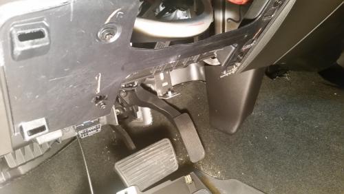

I took mine to the dealer and he blamed it on my key fob hitting the column. I was in my dash working on my light bar and decided to take a look. Sure enough, 3 of the 4 screws had either backed all the way out or were loose.
Simple fixes like this I don't mind doing myself. I shouldn't have had to, but I did it anyway. Good luck tracing it down. I have the jump seat, so I won't be of much help with the console.
