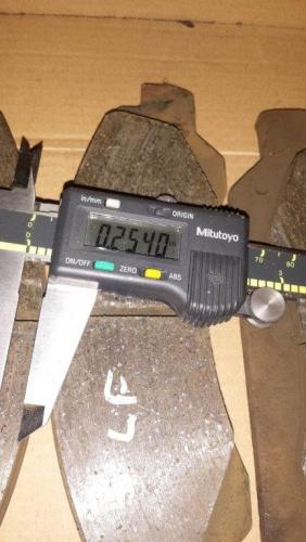

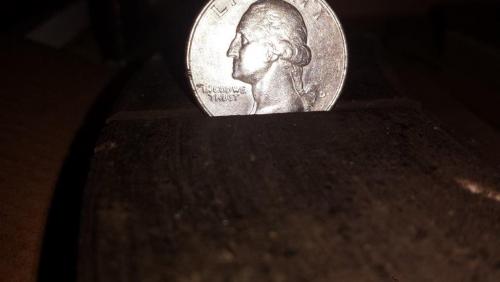

So... I finally got around to changing out the front brakes (will do the rear's tomorrow). The truck now has 107,000 miles and something just shy of 2500hrs (actually rolled the odometer past 107k as I was doing the brake bedding/break-in process that PowerStop recommends). I decided to do the brake change after hauling my trailer around this past weekend and encountering a fair amount of brake shudder.
In reality, I could have gone with brake rotor machining only; (but, having the truck down while having that done isn't an option for me):
post-127843-0-40516900-1504739302_thumb.jpgpost-127843-0-77051400-1504739321_thumb.jpg
The pads had anywhere from .124" to .25" of remaining material to the bottom of the groove - lowest pair of dims were on the right side: .124" and .134"; and the left side had .202" and .254" remaining. Quite honestly, I'm amazed! The dealership tech had commented (at my 97k oil change and tire rotation) that I should consider getting the brakes done as there was some rust scale growing on the rotors and since the pads were OE, they had to be getting near the end. (I don't know why anyone would think that rust scale growing on rotors in non-contact areas means anything significant at all!?!? I mean, I do live in WI - smack dab in the middle of the road-salt/rust belt!) They quoted me $1000 to do it - that was when I started looking for parts on my own.
