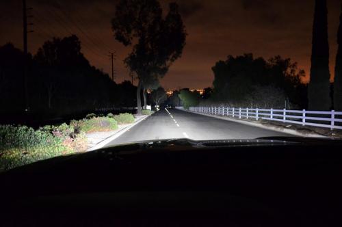

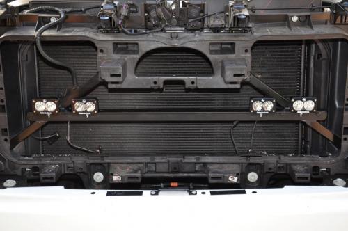

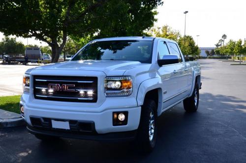

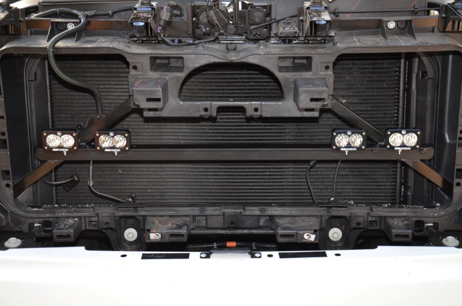

These Baja Designs S2 lights are about as small as I've seen. 2200 lumens and it's very well regulated. Available in a wide flat beam and long range. I have 2 of each beam type to cover it all. I've found that many inexpensive lights claim much higher lumen ratings, but don't control it well and are not as effective. These lights are expensive, but they are U.S. made, the best I've found and they are very small which provides more options for mounting.
I see the new S2 Pro is rated at 2450 lumens.

Looks good on the gmc but the chevy grill would block out a lot of the output. I'm looking for a setup for my 17 Silverado and it looks like the only option is a new grill with built in lights

I'm not a fan of the aftermarket grills. One trick I recall from adding lights behind the grill on a 1971 Pinto, back in the day, was to take a Dremel and reduce the depth of the fins in the grill down to something you can live with, like 1/4" or 1/3" just in front of the lights. This allows more light thru at greater angles. Also, placement of the lights relative to the fins might be more important. You'll have to try it, but I think having a fin dead center on the light may be best to allow the beam to get thru the hole and spread more left and right.
