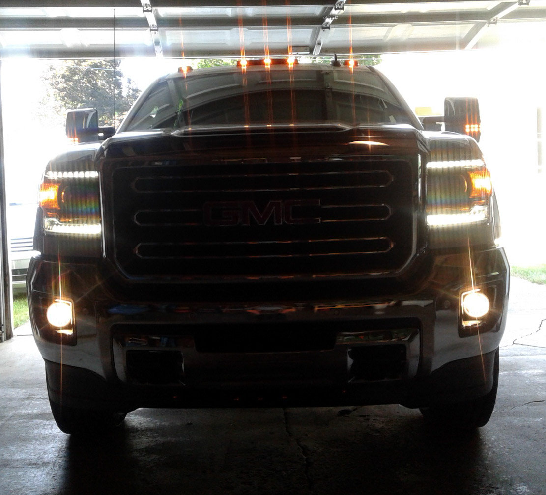

If it's an option then it can be added, there may be a cheaper route than OEM but if you want it to be seamless there is a way, I am sure it has been done 100s of times and the dealer may have a package set up, I bet they do upgrades a lot. Go all the way with power folding and make it work off the key fab. It is so handy to lock it, hold for a second and they fold in, same when unlocking. I use mine every time I park. Get the marker lights, turn signal inside. Mine don't telescope electronically but do manually and I don't tow a pontoon so I may never pull them out. Chrome looks nice and is durable. Then get cab lights to round out the light "face". It was dusk and I drove up to a friend's house and he said my truck was lit up like Christmas.? That's exactly what I am looking for.?
