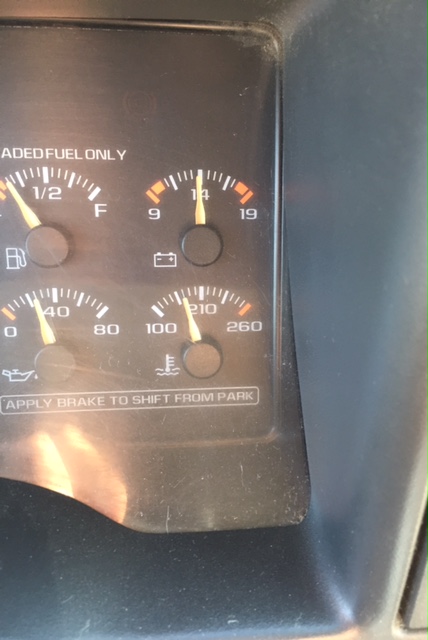

So I just bought a 1996 GMC 1500 for work and I can't get it to heat all the way up. It's almost at 195 but falls short and I'm not sure if I'm over reacting and should leave it or fix it. It has a new radiator, New 195 thermostat, the coolent sensor is new and the coolent sender is new, and I tested the gauge itself and that works fine. Heater core hoses are both hot. Anything I'm missing?! Thanks for the help! I'm in Minnesota so just want to make sure everything's working before winter.
Maybe your gauge isn't super accurate...... Each mark is worth 14 degrees almost.

I think the temp gauge is more for decoration than anything else. The markings don't really make a lot of sense.
Well that makes me feel better if yours is reading the same. Thanks for the input everyone!
I had a similar problem with my '94 4.3L. After trying several senders and getting poor results, I measured it with a non-contact thermometer at the thermostat housing, checking the resistance of the sender, and comparing that to a table. The resistances were different from the table and, in fact, the resistance curve was different - it's not a linear response.
I suspect the parts manufacturers are just substituting a part with the same threads and wiring connection to fit a broader range of engines so they don't have to continue building as many parts for trucks that are becoming more and more rare as they age. I could no longer get the actual GM part. I suspect they are just looking at the external connections when they say it is OEM compatible.
In my situation I'm more concerned with overheating so I removed the gauges and moved the needle on the gauge so it is more accurate when hot. It sits on the first mark to the left of the 210 mark when warmed up. That should be ~195 and I have a 195 thermostat. But it sits between the first and second mark to the right of the 100 degree mark on the left side when it's cold which would be ~125. That's obviously wrong when it's 90F outside but I'm not worried about the low end reading. I don't care what it reads when I first start it but I'll know I have an issue when it passes the 210 mark while driving down the road.

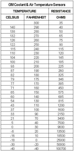

Couple of things, does your OBD scanner read the same temp as the ambient air when the truck is cold? Should be within 1 to 2 degrees. Resistance at 70 degrees ambient should be around 3400 ohms for the ECT sensor.

If you test your coolant sensor, the ohm value at 195 degrees should be around 236 to 260 ohms.
Find a lower 200 something ohm resistor or a variable 1k range potentiometer (solder only two wires where you get a variable resistance signal) from an electronic repair shop / Radio Shack / electronic parts supplier. Stick one end of the resistor in the coolant sensor connector, the other to ground. Same procedure for the potentiometer. Temp gauge should be around 210 degrees. Potentiometer will adjust the temp gauge if under 1K ohms. If this works, replace the coolant sensor, get one from Delco or the dealer, ...not aftermarket because of different resistance values / quality control.
Here is an ohm chart for engine coolant sensors, not computer coolant sensors for the early 90's GM vehicles.
Here’s a temp/resistance/voltage chart for a typical GM sensor early ’90s

95 Tahoe Sport - yep. That's about as hot as I've seen it. I like all my gauges in the middle - makes me feel like everything is normal. But the temp never gets there. I guess it's better than past the middle.

I would be more worried about that alternator than the temp sensor! lol

I will leave you a GM temp chart to tell you where you sensor resistance should be.
Lol, yeah it doesn't look too good according to the dash gauge but shows around 14V out at the battery when running. Guess the cluster is the issue.
Thanks for pointing it out, though.
east321
In your above picture, the volt gauge indication is a very heavy load condition, which in turn is either a no /or low alternator amp output condition for the rpm's that were running when the picture was taken. It is not any volt gauge malfunction.
east321
You know, I think you may have saved me from a breakdown.
I was driving it this morning and noticed the gauge dipping. Checked it again, alternator output was 13.2V at idle. Turned on all of the accessories and it was at 9V.

This is what the gauge shows for 12.98V between alternator post and battery ground.
This is the gauge at 14.33V...
