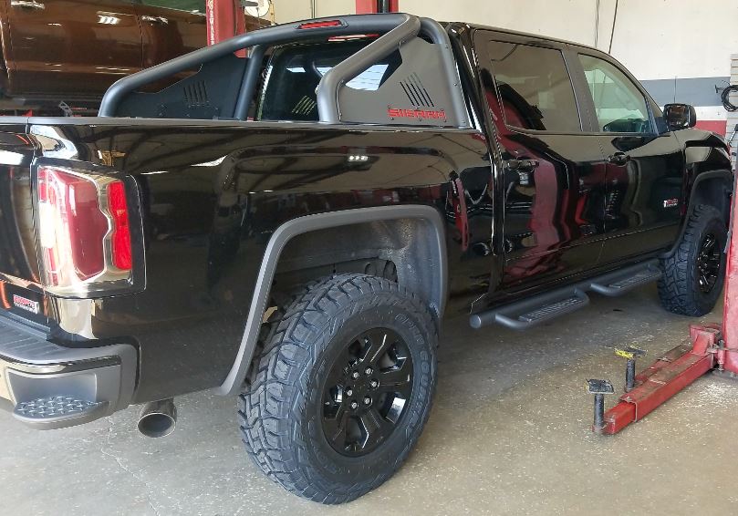

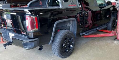

here is a before and after pics. Going from Goodyear Duratracs 265/65r18 to Toyo RT 285/75/R18.
They Filled the void perfectly!
