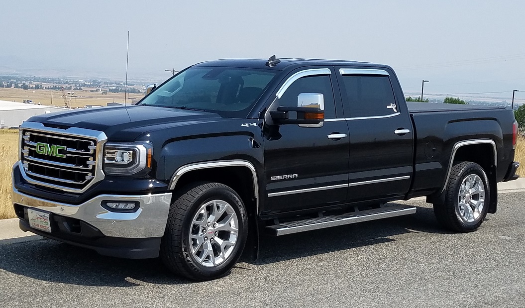

I am sure this has been asked before but is there any way to make the front clearance light on tow mirrors able to be a blinker also? Traded my 2014 SLT Max Tow for a 2017 SLT Max Tow. My 14 did not have tow mirrors but 17 does. Thanks
Since the Cargo Lamp is one circuit that feeds both mirrors, it is not easy to accomplish this.
Boost Auto make a product that can turn them into Dual Function - Clearance Lamps / Turn Signals. This involves dimming the Clearance lamps all the time, then sending full voltage when signal is applied. They have a product that involves taking the mirror/glass apart, wiring cutting/splicing. They have a simplified version that involves the same but in the door panel rather than removing the glass.
