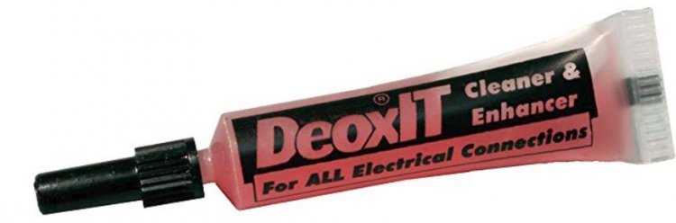

Just want to tell you that this was "right on".  The entire bracket was not coming loose but the plastic base that holds all the equipment was not holding the entire assemble against the windshield, maybe a 1/16 of an inch movement.  I noticed that when I pushed the base against the window that the Control light came back on and the error went away.  BUT, then I noticed that the connector on the back of the camera when wiggled, the light went off (Collision Avoidance) again and cycled, on and off in a 2 or 3 second cycle.  Removed the connector and noticed that it was a super crappy fit, very loose (pin wise).  Put some "DeoxITLiquid" on each of the 4 contact points and pins for the 4 wires going to the camera.  Deoxit is an electrical conductivity enhancer and cleaner, avail on Amazon, pricey but have used it on many application and devices, and the sh&* works.  Will repost if this does not solve the problem.

Just wanted to say thank you for the info. I have a 2015 Sub that has the same symptoms with regards to the "crappy fitment" If I remove and reconnect the plug everything works fine. However in less than a minute the problem would reappear. I will purchase some DeoxIT and hopefully that should resolve the issue.
