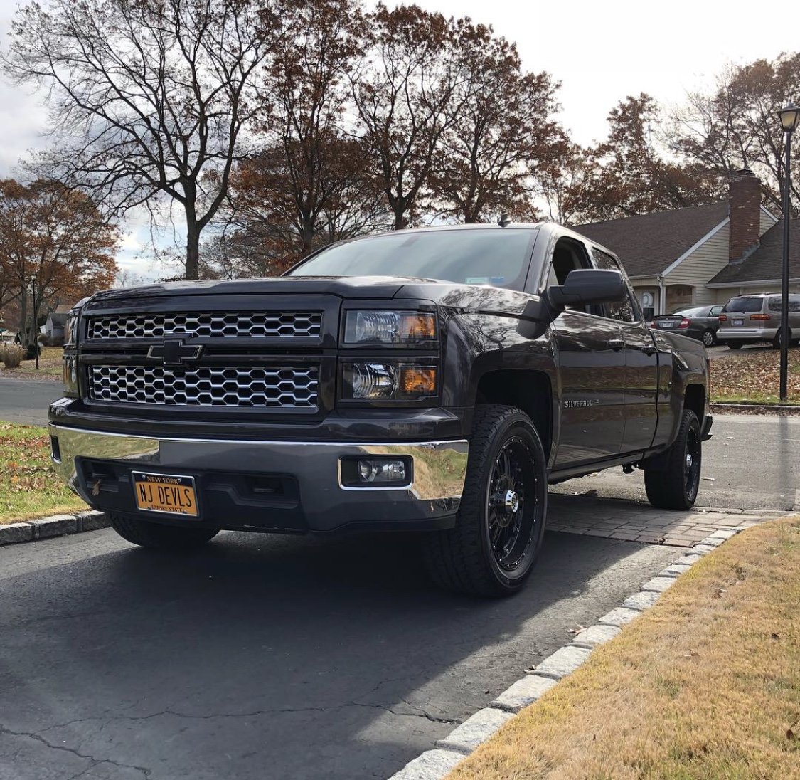

Tungsten Metallic Color Match Project
Looks good! Popping the headlight trim off took me all of 30 seconds. Did it with my hands gently, didn’t even need to use fishing line. Then just add 3M tape and done.
Damn and just like that I’m sold on it haha looks like I’ll be going shopping :)
  • Replies 51
Really?? How so?  Took me like 45 to get off the spare one I had.
I have a grille if u want, in classifieds.
It just sold on eBay actually.  Sorry [emoji20]
Shoot just my luck lol I need to just bite the bullet and paint mine
I do have the new 2017 headlights, but I just undid the clips on the outside with a flathead screwdriver and slowly pulled from every corner. You can feel the 3M tape start to come off. When it started to peel off on a corner I moved to the next one. Did it for all 4 corners and finished!
It took me 45 minutes to clean all the 3M leftover tape off the headlight/trim though Haha
Glad you got this color matched finally going. Making me get more anxious for my blue!!
Lol yea, not near as easy on the 14-15 headlights
2 hours ago, cbrsilv15 said:
Only took me 10 mins to pull mine off. They’re not bad.
what was your method?  assuming take the headlights out, then what?  Did yours have double sided tape (ive heard some don't) ?
It had tape. Just use a heat gun to soften the tape and pry slowly around edges being careful to not gouge the trim. I didn’t use the fishing line method. Heat and a screwdriver.
  • 3 weeks later...
Last update for a while.  Got the headlight trim on.  I love it!! Probably won’t be getting the bumpers done till the spring.  Old headlight trim (chrome) going to be for sale soon.  Keep an eye on classifieds.  Message me if interested.
