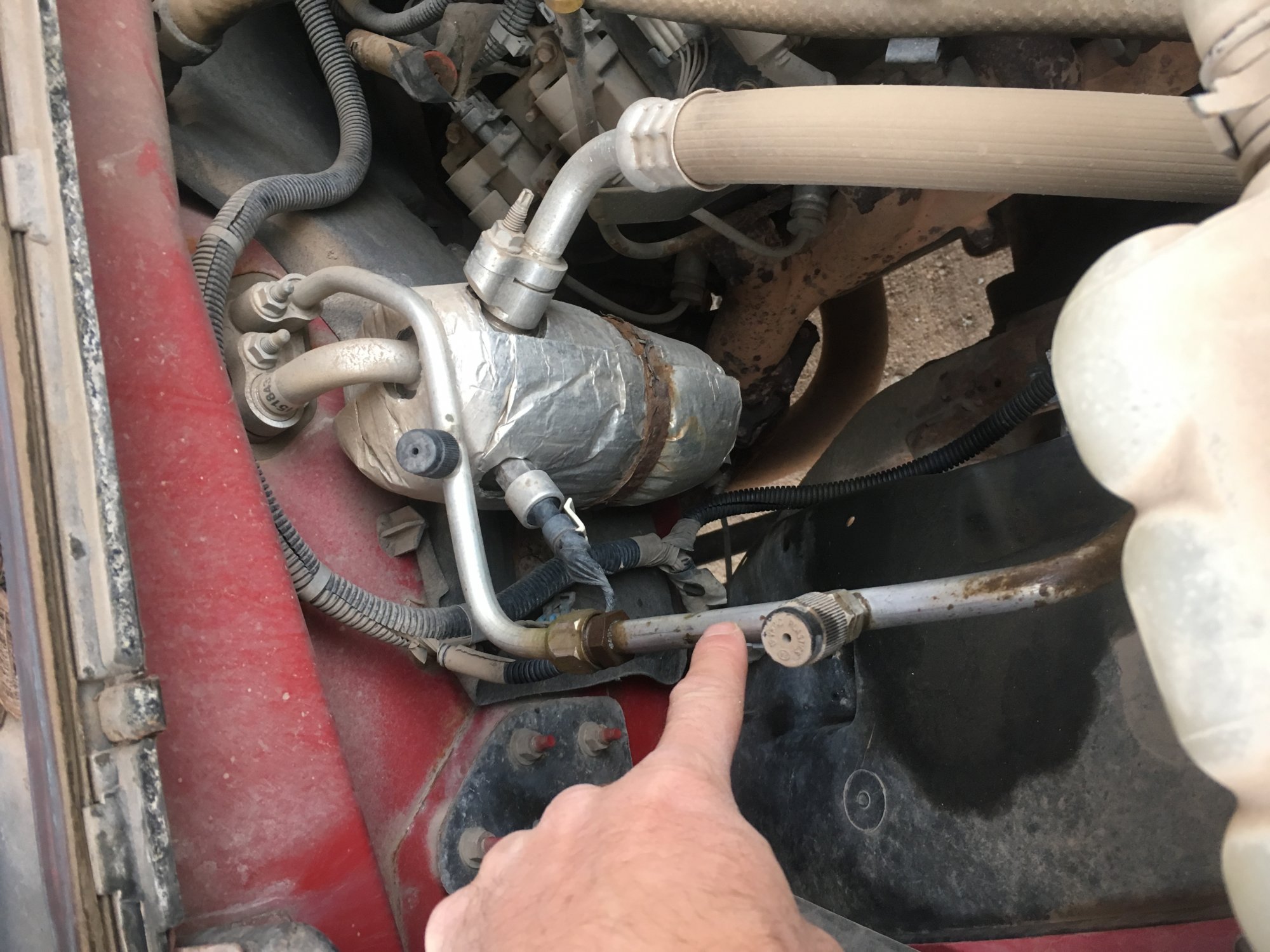

Never seen a stock receiver/dryer wrapped in insulation with what appears to be a large hose clamp (rusty band) securing the insulation. Someone at some point was trying to fix some kind of a/c issue.
That's normal for this vehicle.
On 10/31/2017 at 10:18 AM, Spurrooty said:
Can someone please tell me what this is called and what it does?
That's the high pressure line with the service fitting in it. What is the line doing? The high side pressure fitting can be replaced if it is leaking without replacing the whole line.
