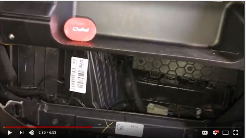

For our trucks, you may have easier access directly to the evaporator. In the photo attached, you are looking behind the lower glove box once it's removed.  The cabin filter is behind the cover with the hex pattern.  I believe the evaporator is to the left where the white sticker is located.  There's two ways I can think of to get the foam on the evaporator.  Easiest and safest is remove the filter cover, remove the filter, drill a small hole (3/16-1/4") in the cover, replace the cover without the filter in place, turn on the high blower, squirt the foam into the hole in a similar scenario I described above for the Camaro.  You could drill a hole into the housing near the evaporator and squirt it directly in that area.  But you better be dang sure you don't damage the evaporator.  If you do, you're looking at removing the dashboard to remove the HVAC housing, which means removing the seats, instruments, etc..  A huge job!  The filter cover drilling is safe and simple and if you totally ruin the filter cover, you can replace it.
