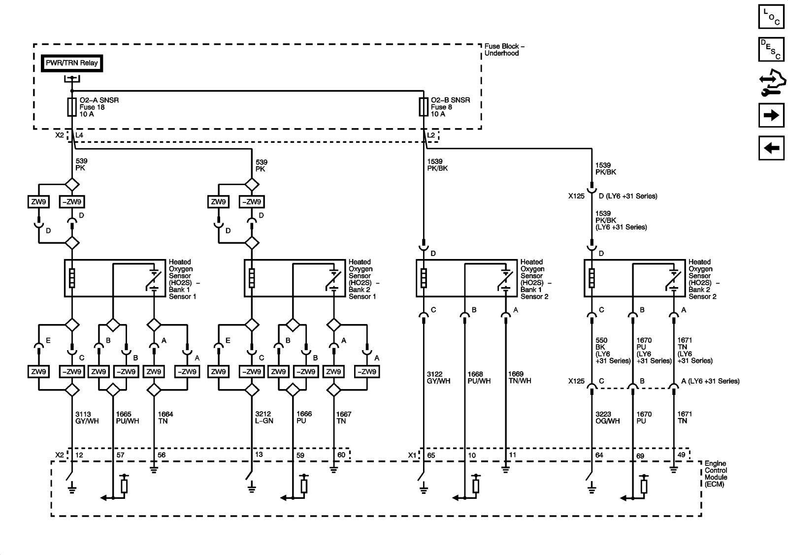

Ok the first thing you need to do is check the oxygen sensor fuses. A lot of times a shorted O2 sensor can cause the fuse to blow and set multiple codes. Let me know what you find and if we need to we can get further into the schematic. Fuse 18 and 8 in your under hood fuse block.
I always say this and I believe it 100% if the fuses are good check it with a fuse buddy and make sure the fuse is passing the right voltage.
Fuse buddy. http://amzn.to/2iEmCq4
