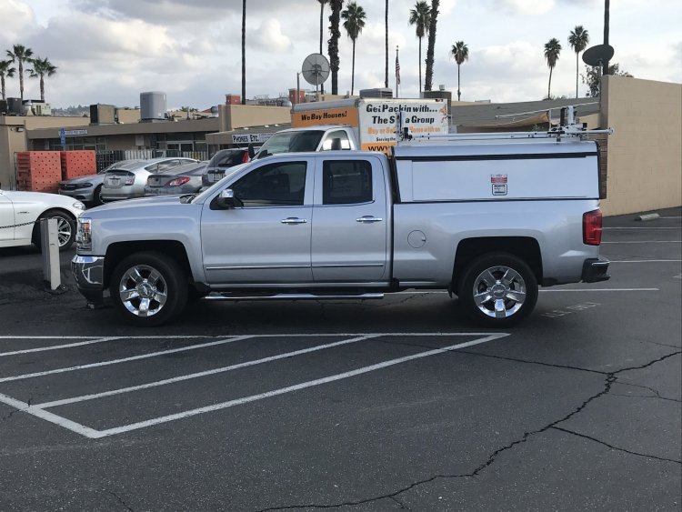

In late June 2017 I purchased my FIRST Silverado. Use it mainly for my business. And I didn't skimp on this purchase, it's loaded.... And purpose built with custom ARE shell, Prime Design Ergo Rack and Cargo Glide. What turned me in this direction is my prior corporate use of Silverado. I loved that truck, it took me where I needed to go and endured much abuse. But that experience was over 10 years ago. Still, it pushed me into purchasing a Silverado. But my experience has been a bit... uncomfortable... well, except for the heated and cooled seats. :D
Fast forward 700 miles to early July 2017 and my NEW truck just dies in the street. And I have a LOT of work to do. Stablitrak light came on and solid engine light. I hobbled it a few miles home where OnStar arranged for a tow back to the dealer of sale. Diagnosed as bad lifter at #7 and spark plug. They gave me a basic loaner for about a week. 700 miles! So I'm already hot. Asked about a buyback which they didn't act upon. Oh well... hey I owned the truck for two weeks, right? :lol:
Get it back and truck does what it's supposed to do for about 7500 miles. Fast forward to Nov 2017, where I go in for a complimentary oil change at my local dealer (not sale dealer, but shouldn't matter... right?) and they do an update for the transmission control module... because they show it needs to be done. Business as usual... until I start getting check engine and stablitrak lights about twice per week, if not more.  Happens sometimes when taking corners, occasionally uphill as well. The ride is increasingly getting worse. Vibration and hesitation at idle most prominent and still very noticeable when driving. Truck lunges from complete stop and seems like late shifting from rear when coming to a stop. Strong drop is the only way I can describe it. You know it's bad when your daughter asks if the truck is supposed to feel "like this" when she's sitting in the passenger seat. Most times the lights go off in 3-5 minutes, which I guess is the computer correcting the engine. But why should I have to put up with this on a NEW truck?
A few weeks pass and I take it to same local dealer week before Christmas only to be told to make an appointment and drop it off. I told them I can't predict when the truck is going to act up, how I can make an appointment for that? I did make appt for 7AM day after Christmas, where they had the truck for two days and unable to duplicate problem. No loaner.  I pick it up and it is getting worse. Misfire on cylinder 8 now they say.... that whole P0300 code thing.
