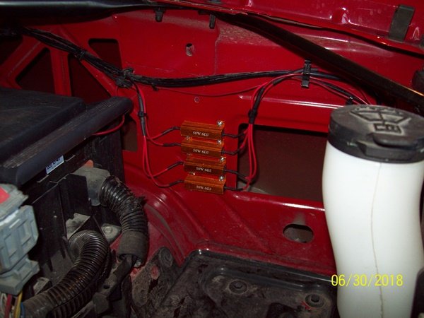

I have a 2015, two turn signal bulbs on each side. Someone on this forum said you need a resistor for each bulb, and I found that to be
true, I tried just one for two bulbs, didn't work, hyperflash still. So I ran two resistors in parallel, two wires down to one and spliced

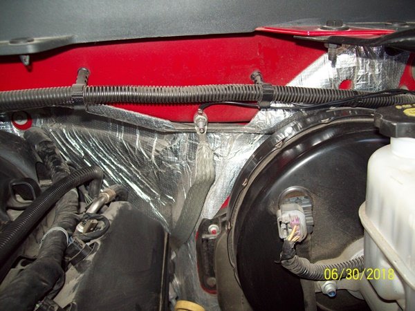

into the 6 pin connector. One wire spliced into the turn signal power wire, the other end of the resistors, did the same and ran that wire to
the body ground located on the firewall. Works great. Mounted my resistors on the inner fender, easy to get to.
You could probably do the same for your set up and only have to drill one hole in your socket.
Two resistors for each side, just ran a wire to the right side and spliced into the 6 pin connector over there.
Good solid solder joint. I wouldn't use the scotch locks they send with the resistors.
Run the other end of the resistors to the stud.

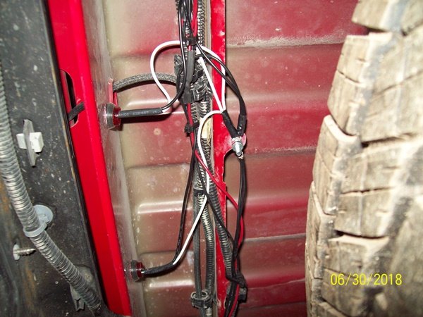

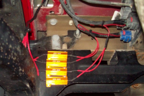

The same thing can be done for the rear turn signals with two bulbs on each side...there is a junction block
just to the left of the spare tire, one wire one splice, then just find a good ground.
Rear resistors mounted to reese hitch, single wire to junction box plug. Other end going to ground.
Made my own ground, I have some other led's grounded to the same stud with no ill effects.
