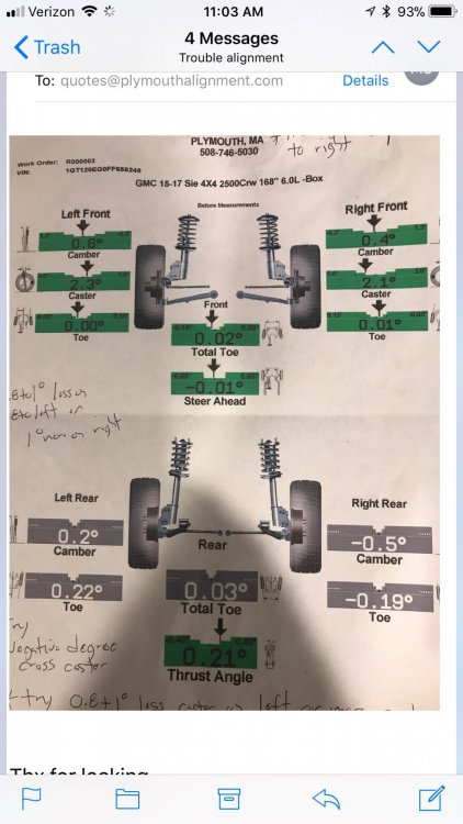

I've read multiple posts concerning possibilities for a resolution for my truck pulling to the right but wanted to post my specs up here before approaching yet another alignment shop in case I'm missing something.  My feeling is that either the rear end is throwing off the alignment, the shops are not aligning the front to the rear, or the simplest answer to just add more caster to the right front wheel may be the answer.  Am I missing anything else? I would say the last idea I wrote is likely the answer until I started to understand a bit more about my rear wheels in the attached alignment printout. Now I'm a bit confused.  Let me know what you guys think so I can intelligently approach a shop again.  BTW, when I did approach the shop that did the initial alignment, requesting caster in the 3's with about 3/4 more in the right, they said no way.  They are also the ones that sold me the tires and did the original alignment.  BFG AT KO2 one size up from stock.  33x11.50.  Truck drove perfect with the old tires.  Also, the tires have been rotated with no help.

Notice that the factory alignment specs differ from side to side? More positive castor and camber on the drivers side? That is to help with 'drift' on the crown of the road. I also note you have almost a quarter degree of thrust angle. Dog walk will push it off line. I also took note their have been two other alignments and multiple tire rotations with what I gather is no effect at all? If it was tire it would have changed following the tire.
That the case 1.) thrust angle 2.) rear axle not square to the trucks centerline 3.) You may have a caliper slider stuck with some mild brake drag.
